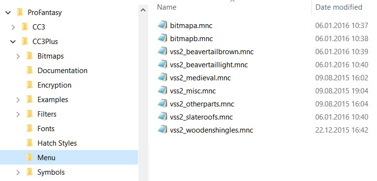

  • I was having some trouble with the symbol catalogs appearing blank. What I found was what I think is an issue in the vcc_cc3plus.zip file.
    In the file, in the menu folder there are the menu .mnc files. These files all have entries similar to the following:
    Base Buildings:|CATALOG @Symbols\Medieval Symbols\Base Buildings Brown Beaver Tail.FSC;
    This says the FSC file should be located in the @Symbols\Medieval Symbols\ folder.
    However, in the same zip file, all of the FSC files are located under the @Symbols\Medieval\ folder and not in the @Symbols\Medieval Symbols\ folder
    If I copy the FSC files over to the Medieval Symbols folder, it works fine and the catalogs show up as expected.
  • Unfortunately, you're right. This is an error. See the posting for Patch 02 below. Thanx for letting us know!
