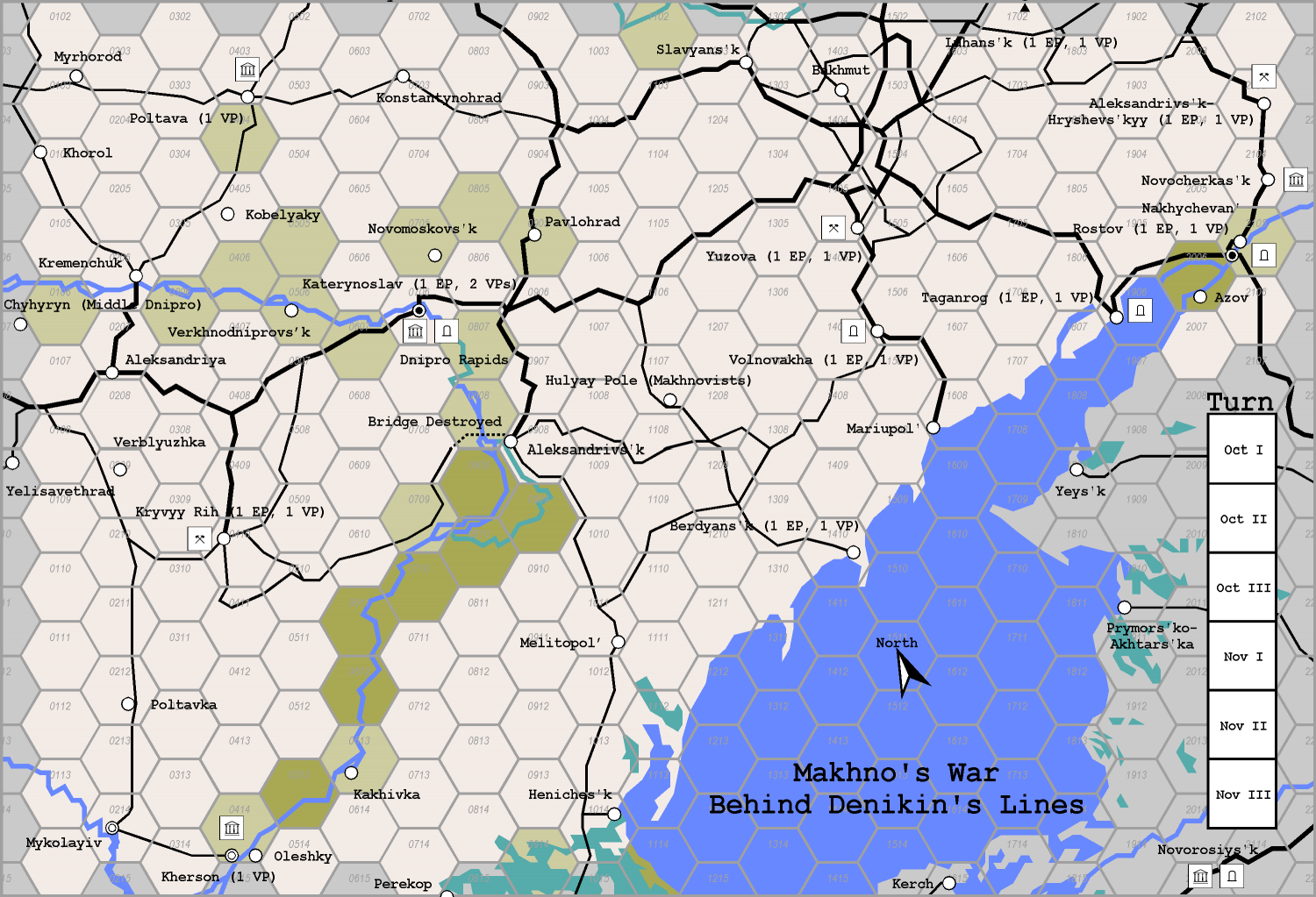

I made a test version using the Fantasy Hex style for the terrain:
The Fantasy Hex style created 2 sheets for land and sea symbols. I also tried the Mike Schley Hex style, but it created *several* sheets. I also tried importing 3rd-party hex tiles, but I'm not sure how to scale them during their import.
I had to move the town/city icons to another sheet, "points of interest," before adding the hex tiles. I moved points of interest and text to the bottom of the sheet list, putting them at the top when assembling the map. I moved "symbols" up just below the "bitmap" sheets, which are hidden here. I applied a 50% transparency to "symbols" so they would be lighter, and so the rivers, railroads, etc. would stand out.
... It looks like the North arrow stayed with symbols and disappeared under the sea.
I think it's too hard to distinguish navigable from non-navigable water, and broken from rough terrain. I am going to need to add hex numbers again. I would prefer not to have the large tree icons.
I transliterated place-names from period Ukrainian-language maps, instead of from current standard Ukrainian-language spellings.
I've done a couple more edits, and tried a couple more styles.

Here's the current working version. It's about half the area of the original game map, and at an angle to it.
CC3 Overland Hex:
Mike Schley Hex:
In each case, I've applied a 25% transparency to each of the hex symbol layers.
Since most of these sets have different symbols for plains and farmland, I might want to find a population density map and use these symbols to show that. But for game purposes, I should probably use the clearer symbol throughout. I tried some other hex symbols, but the scales weren't right.
Also, I need easy-to-see and easy-to-distinguish symbols for moderately difficult and very difficult terrain, and I'm not finding that; I figure most of the foothills and marshes are wooded, so I can use wooded and more-wooded instead of different symbols for hills and marshes. But either they blend into the open terrain or inte each other.
Also, I want to fit the final map on either 2x Letter or 2x A4 pages, for easy printing, and I expect to give up a couple rows on the edges.
