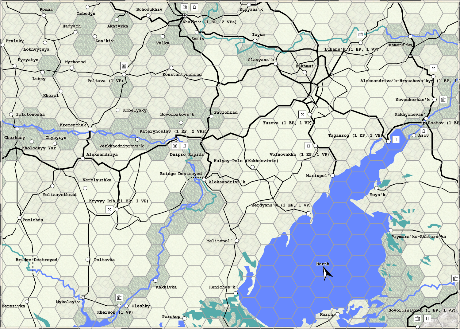

  • I'm drawing the river as a zig-zag with width 2, so it's easier to see, and so it's wider than railroads. I may need to use width 4. I'm drawing the sea as a polygon. At the mouth, the river divides into several branches, I'm only showing the northernmost and southernmost major branches; as it meets the sea, there's a pair of notches becaue of the mis-match between width-2 and width-0 objects. I've overlapped sea and estuary elsewhere to avoid the notch.
    I'm also having some trouble with small islands and lakes, especially in the Sivash; they're too small for the snap grid, and not worth the trouble of a more detailed grid.
    Once I finish tracing the coast (as a set of polygons), rivers (zig-zags), railroads (more zig-zags), etc., placing the cities, etc. I'd like to see which styles will work with them.
    Then I'm not sure where the white is coming from.
    Please can you upload the .FCW file (the drawing file) to a comment below, so that we can inspect the problem?
    It should upload if you hit the paperclip button at the bottom of the comment box.

    The white comes from the background.
    I'm guessing really wildly now because I don't know what's happening in the drawing, but I think you might need to edit the estuaries so that the coastline meets each river in turn.

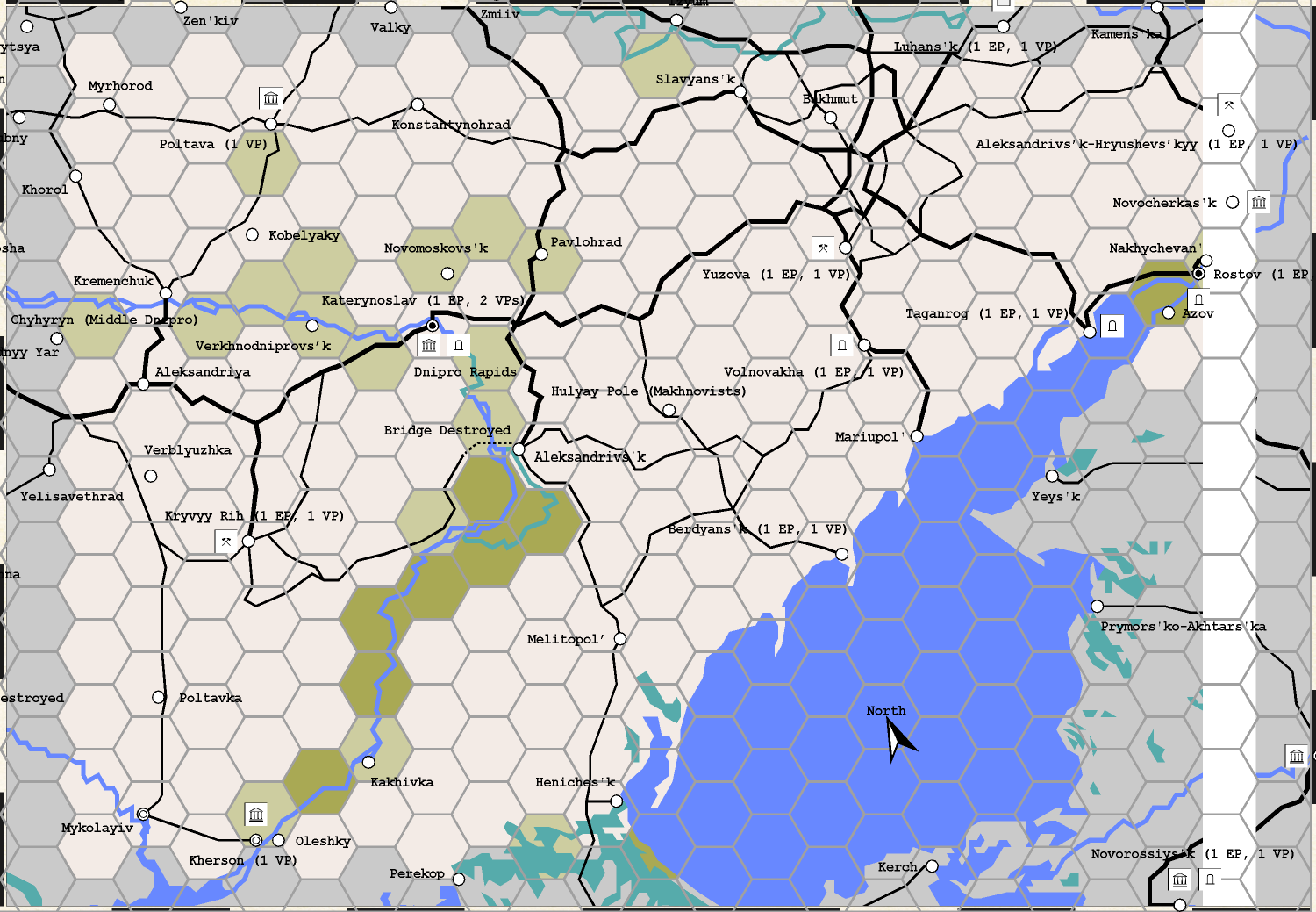

    I made a test version using the Fantasy Hex style for the terrain:
    The Fantasy Hex style created 2 sheets for land and sea symbols. I also tried the Mike Schley Hex style, but it created *several* sheets. I also tried importing 3rd-party hex tiles, but I'm not sure how to scale them during their import.
    I had to move the town/city icons to another sheet, "points of interest," before adding the hex tiles. I moved points of interest and text to the bottom of the sheet list, putting them at the top when assembling the map. I moved "symbols" up just below the "bitmap" sheets, which are hidden here. I applied a 50% transparency to "symbols" so they would be lighter, and so the rivers, railroads, etc. would stand out.
    ... It looks like the North arrow stayed with symbols and disappeared under the sea.
    I think it's too hard to distinguish navigable from non-navigable water, and broken from rough terrain. I am going to need to add hex numbers again. I would prefer not to have the large tree icons.

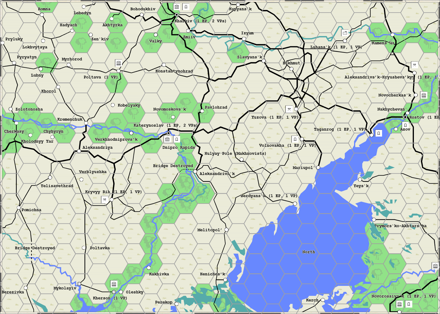

  • I've done a couple more edits, and tried a couple more styles.
    CC3 Overland Hex:

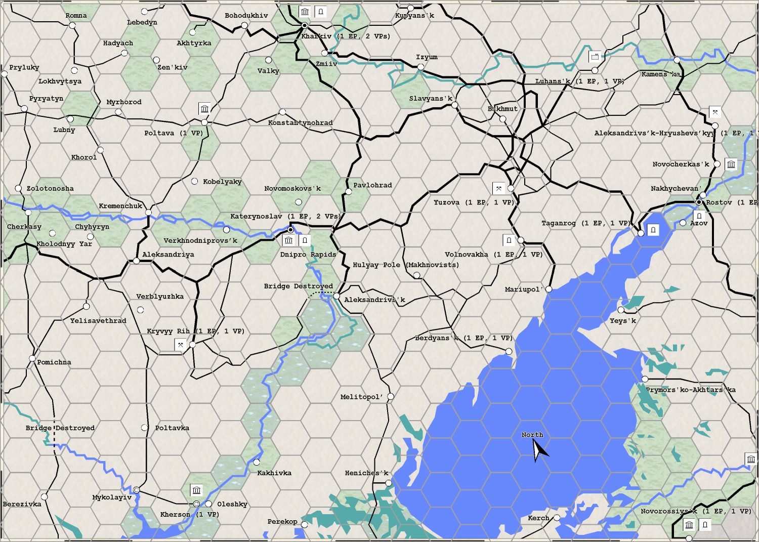

    Mike Schley Hex:
    In each case, I've applied a 25% transparency to each of the hex symbol layers.
    Since most of these sets have different symbols for plains and farmland, I might want to find a population density map and use these symbols to show that. But for game purposes, I should probably use the clearer symbol throughout. I tried some other hex symbols, but the scales weren't right.
