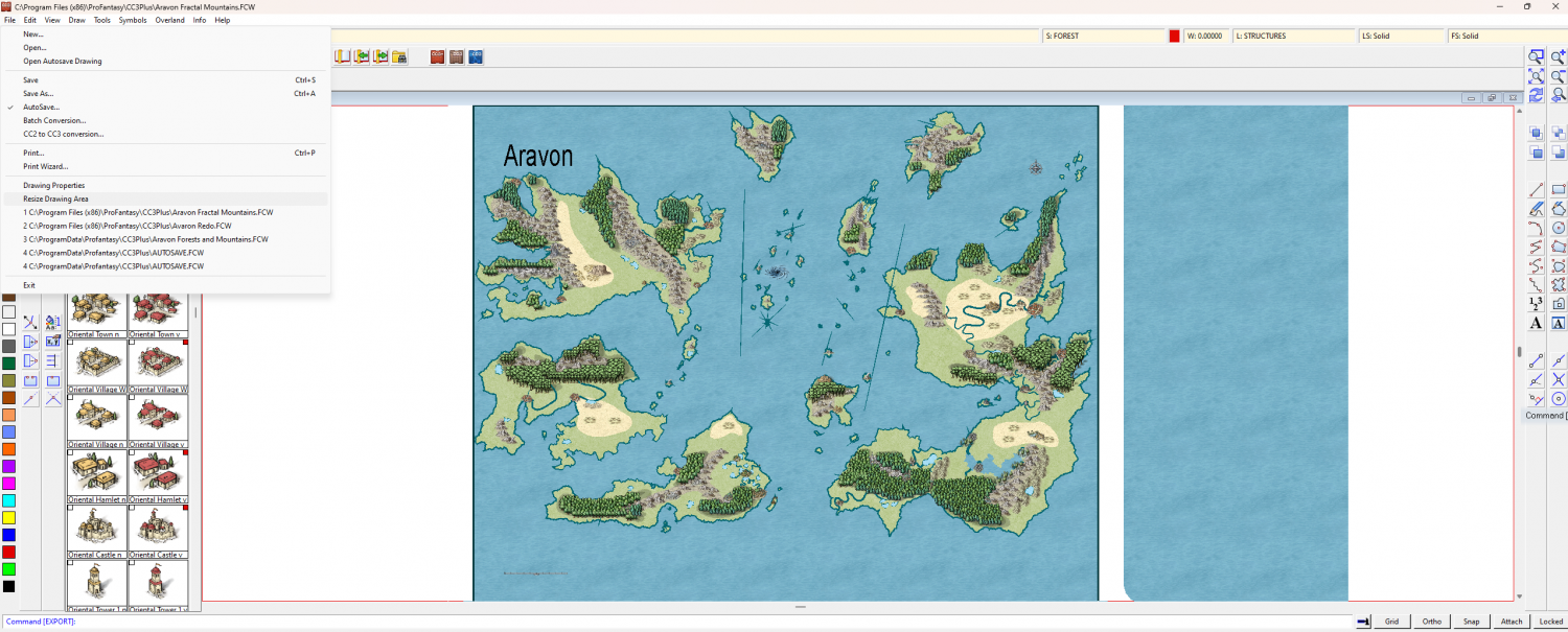

    Do you have the latest CC3+ update (Update 25, CC3+ 3.94 as of this writing)?
    Resize Drawing Area should appear right below drawing properties in the list. It was added in an update, but that's a year or two back now.
    Hmmm.. Seems like your menu file haven't been updated for some reason.
    Try running the CC3menuconfig.exe file found inside your CC3 plus data directory. (Close CC3+ first). It doesn't have any visible output, so it won't appear to actually do anything, but it does it's job silently.
    You can also access the command by typing SCALEMAPEXT on the CC3+ command line

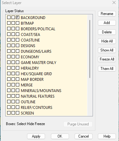

  • Make sure you look through both SHEETS and LAYERS on your top tool bar.
    Ensure that none are locked, frozen or hidden.
    That could be a possible culprit. Those prevent changes, and if you resize, it may not have enlarged. Or may not have copied at all.

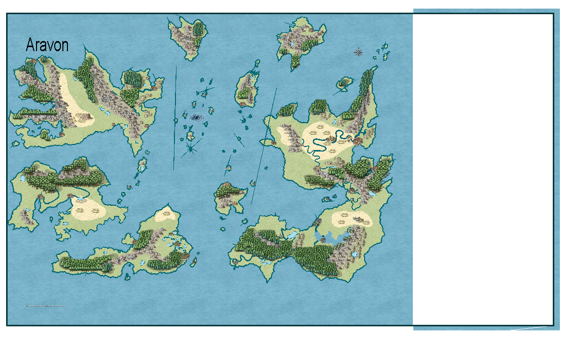

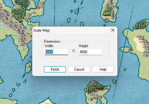

    I change 5,000 in width to 7,000.
    I get this.
    The reason that I am having this problem is that the windows viewer will not resize the map to print nicely on an 11x17 page is there anything else I can do?
    Thank you for the help!
    edited April 2025
    Ah, I see what the problem is. There's a white polygon on the SCREEN sheet and layer. It goes all the way around the map to hide bits of mountains and things that are only half inside the map. It's called (rather unsurprisingly) the screen.
    Resize Drawing Area usually works without a hitch. Sometimes, however, if the difference between the original size and the new size is very great, it doesn't scale the Screen properly, and that is what's covering your background on the right side.
    You can get rid of the damaged screen either by deleting it now that your SCREEN layer is unfrozen, or by using the command COLLARDEL, which you type on your keyboard and then hit Enter.
    To make a new one just type the command COLLARAUTO and hit enter again. That should automatically draw a new screen on the correct sheet and layer. Once done, it would be worth re-freezing the SCREEN layer so you don't keep accidentally picking it while you are working on your map.
