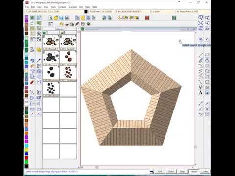

    I wanted to try this shaded roof technique, and I felt that it was just like magic! In order to demonstrate that, I created a small video on how to draw a pentagonal roof in 3 minutes... It there:

    Thank you, Thank you, Thank you, Gathar :D
    I just couldn't work out what the "shaded polygon (angle by edge)" was supposed to do, and spent ages adjusting the angle by degrees entered on the command line.
    At least I know now - ready for next time.
