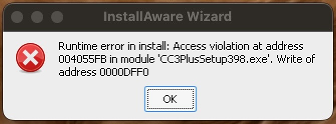

  • I have tried a few times this week to install CC3 using crossover. However it has an error. Does anyone know a work around. Am using a MacBook Air 2024.
    Thanks

    what error are you getting ? , if this is a memory error then ralf sent me a test install but this install fails to recognise my serial number when it is first run , a work around would be to install crossover on a intel mac or a linux box then export the cc3+ bottle to archive and then reimport the archive into your macbook air

  • It is a M3 Macbook Air running the latest version of Sequoia. It does the .NET framework install but then I get the following:

    Give support a shout , Ralf sent me a test setup a little while ago however that test setup didnt like my serial number but installed as a save disabled program with a notification box displaying to please contact support
