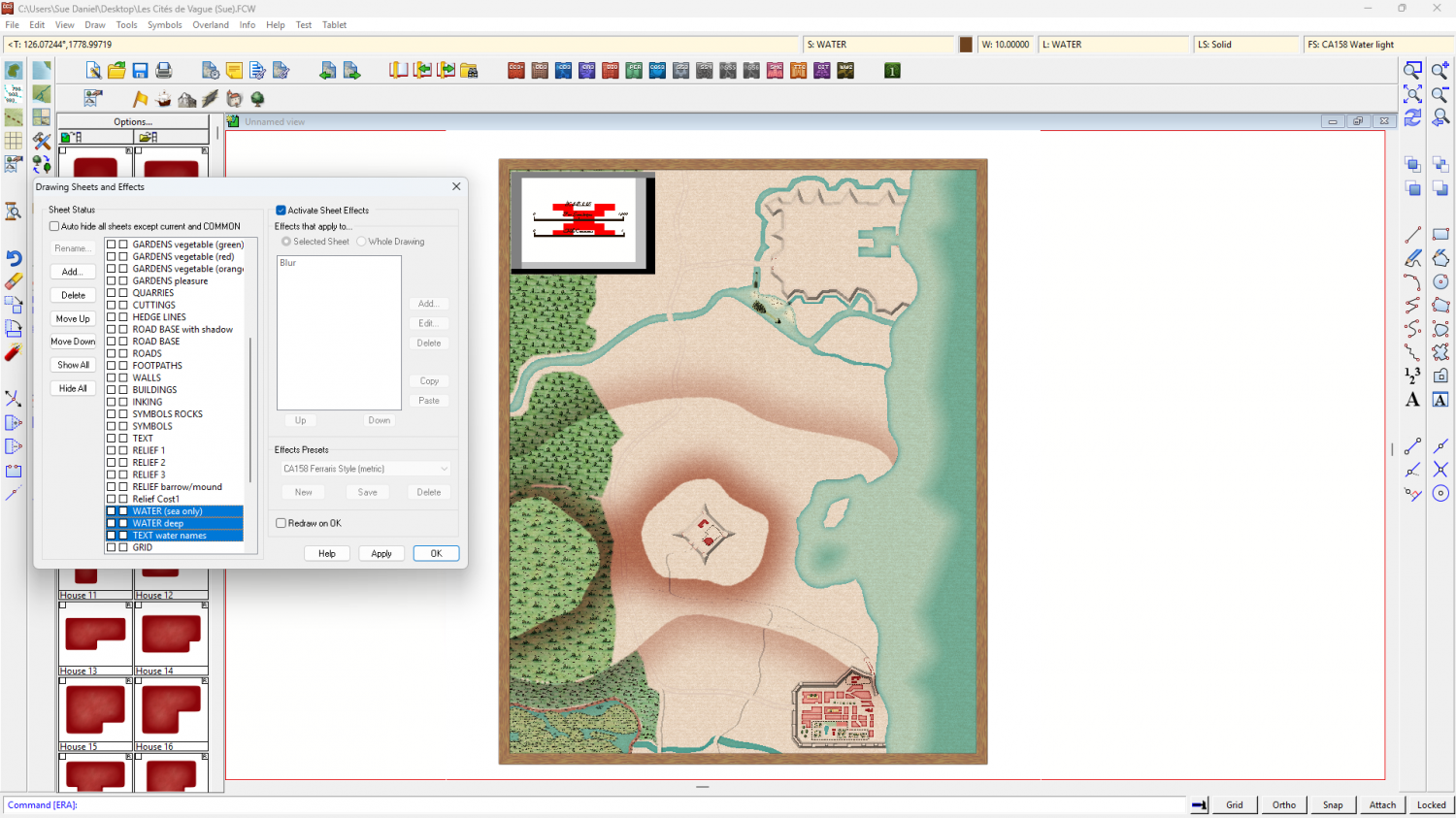

    I created a second WATER sheet, called WATER (sea only), copied the sheet effects across from WATER, then copied just the sea parts of the water to it. This was to preserve the rivers and marshes. Moving them down the list by moving the original WATER sheet did bad things to your map.
    Then, because CC doesn't react well to having the exact same shape with the exact same fill on different sheets I changed properties on the original sea polygons on the WATER sheet to a solid grey colour, knowing that they would be entirely covered by the new sea polygons on the new sheet.
    However, even though at first glance it all looked great, zooming in to the coastline revealed that the rivers were now blocked by black lines - the dark glows on both WATER and WATER (sea only). So I removed the dark glows from the new WATER (sea only) sheet, and added a series of Edge Fade, Inner sheet effects to it so that the black line effect from the underlying (and now grey) original sea polygons on WATER were visible just around the edge but without revealing the grey polygons.
    I had to move the deep water down so it still appeared on top of the new WATER (sea only) sheet.
    Summary:
    The original WATER sheet is exactly where it was but only has the rivers and marshes on it, with a grey copy of the sea. The WATER (deep) sheet has been moved right down the stack to stay on top of the new WATER (sea only) sheet, and I've moved the TEXT water names sheet down for the same reason - so the labels stay on top of the sea.
    As I said at the outset, this is a 'here and now' fix and might break. But if it does cause problems as you map more details, shout again and we'll have another look at the situation.

    1) I struggled with copying the sea shape to the extra sheet. (Right-click on copy, copy to sheet, select the sea (only) copy it to the sheet. Nothing seemed to happen.
    2) Having a new sea contour on the extra sheet to just block the contours did kinda work, but you could still see some of the effect. (Lots of seas and sees in this message...)
    2b) I still do not quite get, why on the original sea sheet you can see the blue edge fade effect... from where? the colour is brown?
    (Anm. d. R.: It is now a glow! tricky!)
