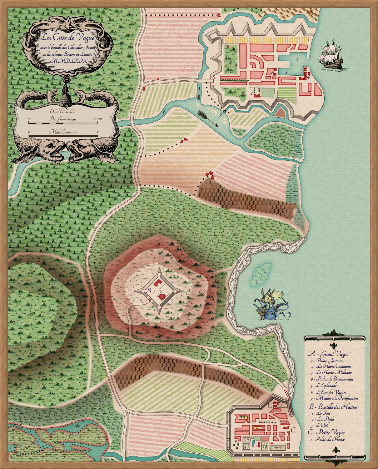

Sooo... I keep coming back to this style time and time again. And I am still learning. This time I hit a bumper when doing the reliefs in the Ferraris style. Normally, they are closed polygons which have this need effect to visualise the slope
However they are always closed contours. How can I get this effect with a line only? I want to visualise a cost which has cliffs. So on land there are slopes, but on the see I am planning to do something similar like treasure island style.
I can move the slopes to another sheet under the water sheet, but then it is also under the terrain sheets and the forrest above would cover it. I could try to do some sheet juggling... which will probably drive me more crazy then I am already. +puppy-eyes+ Any suggestions?

If I understand you correctly, you want a cliff behind a cliff. Try making a second closed poly on a different sheet above the base landmass with the same effects. Draw your line but then close it around the outside of the map so you can't see that other side.
I suppose this works only on a contour that doesn't end in the middle if the drawing. If you need that, try a third sheet on top with no effects with a landmass that covers the part you dont need.
