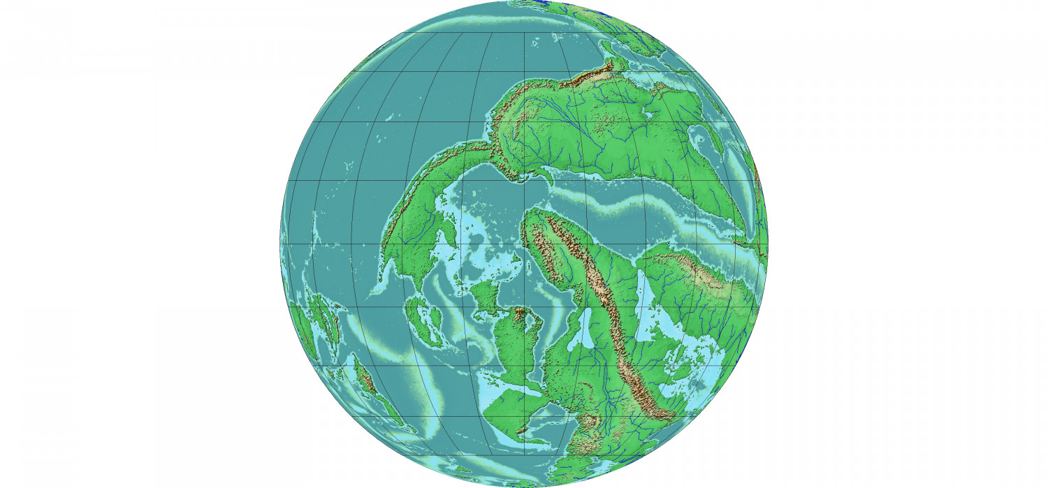

    I've been experimenting with using Rock3, Wilbur, and FT3+. Run the tectonic simulation in Rock3, export the 4 channel png file. Open in GIMP and select only the red channel, covert that to grayscale, export as an 8bit PNG. Open that in Wilbur, tweak the span to match the terrain output png from Rock3, export from Wilbur as an MDR and import into FT3+. In FT3+ you'll need to burn into surface and adjust the water level somewhat to match the original picture output from Rock3 again.
    I've not yet done any erosion via FT3+ or Wilbur, but am starting to mess with the erosion function on Rock3.
    So far I really like how the worlds look in FT3+ and am continuing to experiment with it.

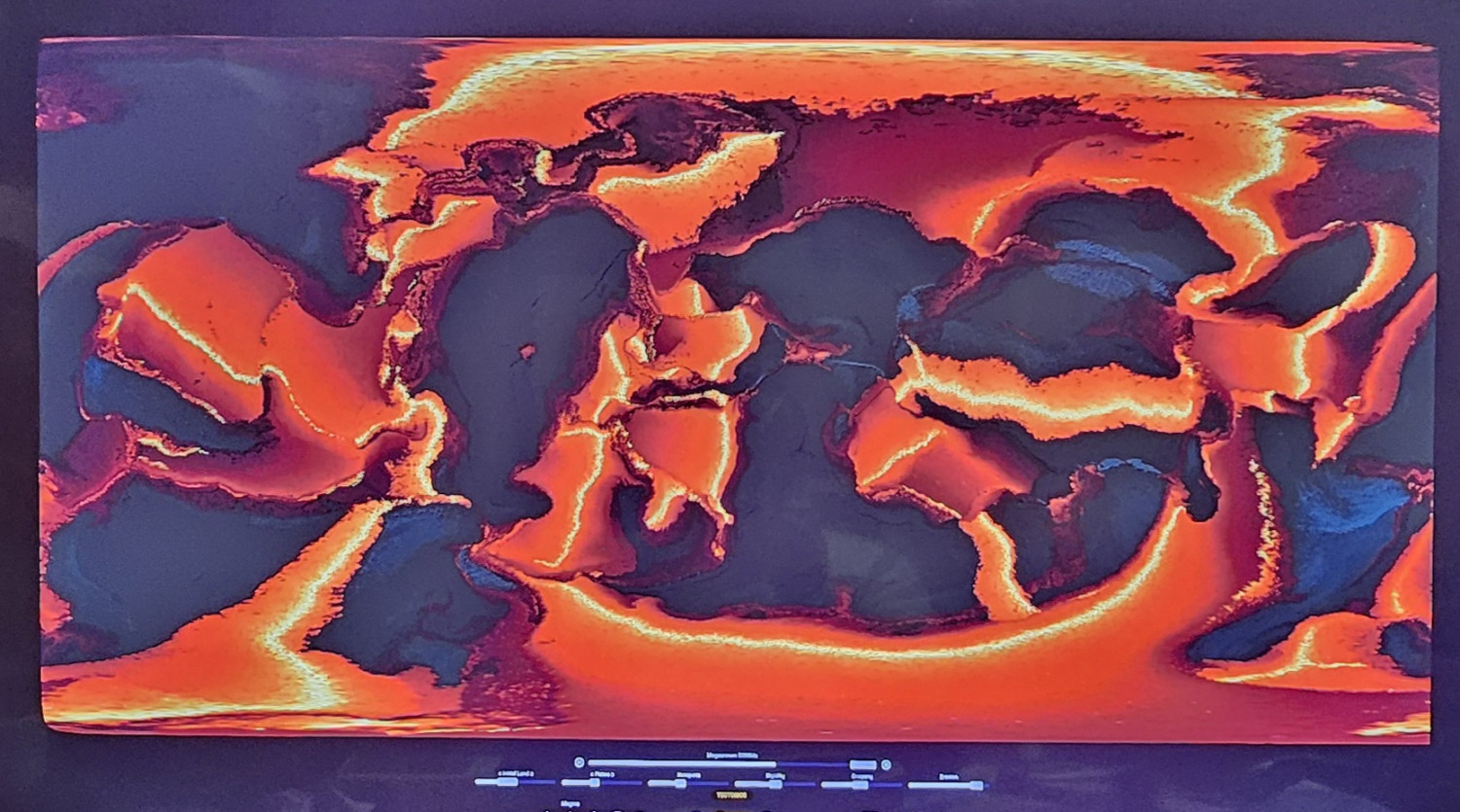

    One thing I really like from Rock3 is the magma view...but you can only see it while it is running the simulation. Once that is done, the magma view is not accessible, as far as I know.

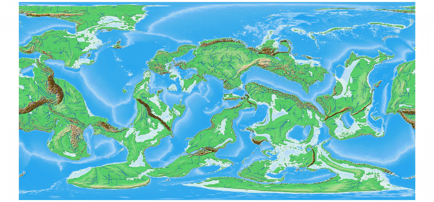

    Here is a different world after importing into FT3+ and finding rivers.

  • Yet another world taken through ODWB Wilbur process. I'll have to reduce the resolution (currently 22000) to export it to CC3+, otherwise artifacts in the exported file.
