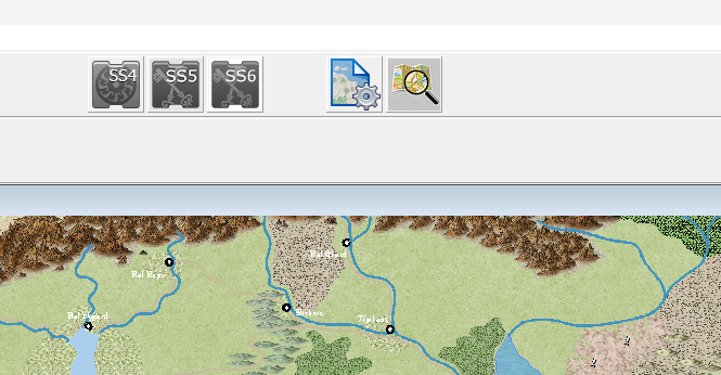

I have watched a few tutorials and had a one on one with one of the tutorial creators, and read the help files for CC3+, but I still cannot get a homemade icon to appear on a customized button that brings up a list of my various created symbol files.
Here is the code I am using, and the compass bitmap file is in the same working directory as FCW32.mnu
#609,compass.bmp:[Mysymbol Menu]|CMENU @menus\mysymbol.mnu;~|LOADCC3;MENUDM @mysymbol.mnu;
Any assistance would be greatly appreciated.
Rob

try putting the icon bmp into Bitmaps\Icons and making the line #609,@Bitmaps\Icons\compass.bmp: ...
The @stands for the cc3+ program folder and it should work without the Bitmaps\Icons\ part if you just put in the @, but it's usually better to have the icon images in one common location.
Good info, works great!
