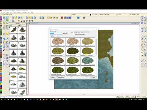

    There are several ways to do mountains in CC3/CC3+. Use different colors, or different bitmap fills, to show a range of heights. Like a topographic map. Or use mountain symbols, and label them with text and an arrow. 20,000 feet --> ( It looks better in CC3/CC3+)
    Here is one method, I no longer use it because it can become tedious:
    I created layers for elevation ranges, added bitmap fills for each of those layers and added them to a template.
    So my maps have varous bitmaps, shades of green, brown, and icey blue, for varous elevation ranges. Shades of blue for the depths.
    Color chart for Crestar surface maps you will need the bitmap fills linked there to. Or create your own bitmap fills.
