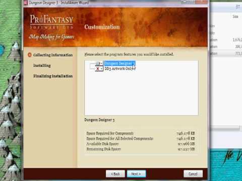

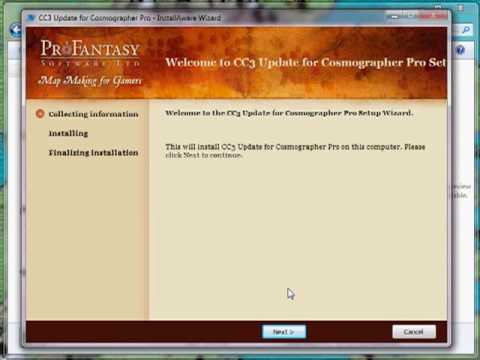

    For CC3 the instal order is:
    CC3
    Update (if needed)
    DD3
    CD3 (and the High Res CD3 bitmaps)
    Update
    The most current update installer is always run after you install an add-on for CC3 as it finalizes some things. Note, that the Updater may uninstall first when you rerun it, so just run it again and install it if it uninstalls
    You want to right click and run the installers as an Admin if you are using Vista or higher.
    The CC3 & CC3+ versions are different so you need to install both if you plan to have CC3 & CC3+ installed.
    See also the FAQ as it has info on installing.
    https://secure.profantasy.com/service/faq.asp
    Joseph Sweeney also has some tutorial video that shows you how to install CC3. (I recommend you watch all the other videos he did too.)
    Also make sure you download the free annual issues that are available too.
