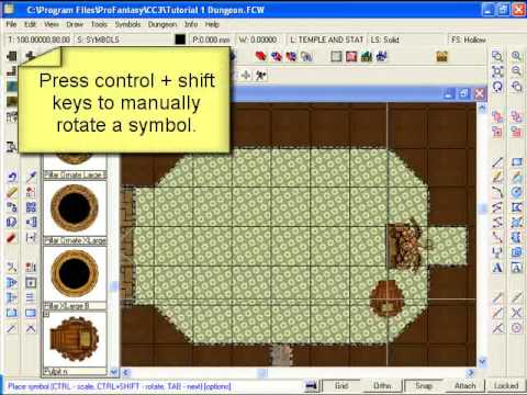

    At about the 1 minute mark he's showing a menu of doors and at about the 2 minute mark he's showing a menu of temple items (statues, etc). In both cases the list of symbols is much greater than DD3 seems to have (unless as stated there's a way to expand the DD3 symbol catalog available via the symbol icons).

    The pillar used starting at about 4:25 (The aforementioned column I do have doesn't line up the same way as in the video)
