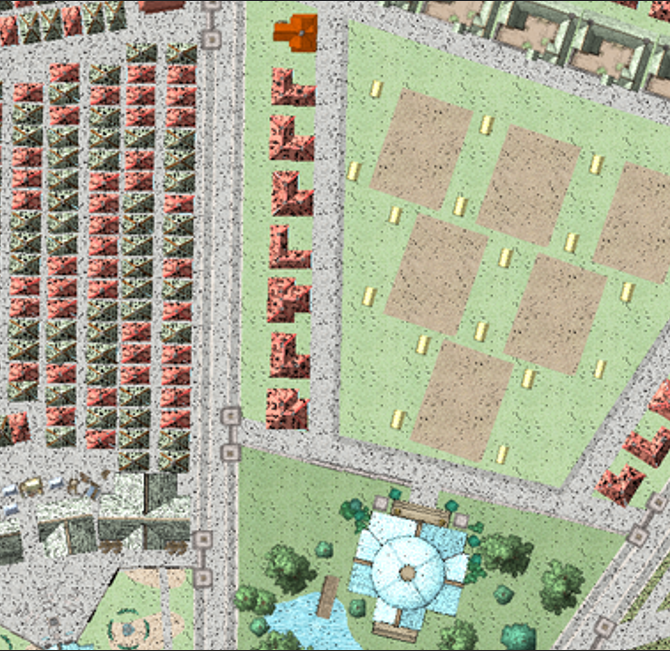

so i'm done with enough of my map that i'd like to save a chunk of it to share, and i'm having some trouble exporting. i've followed what tips i could understand from searching other threads (setting exportsetmppp above 4000000, checking png/bmp/jpg settings) but i'm not having any luck.

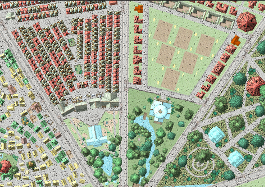

my maps are exporting either completely borked or without any sheet effects and at very low quality. i've tried saving as a png and get this result:

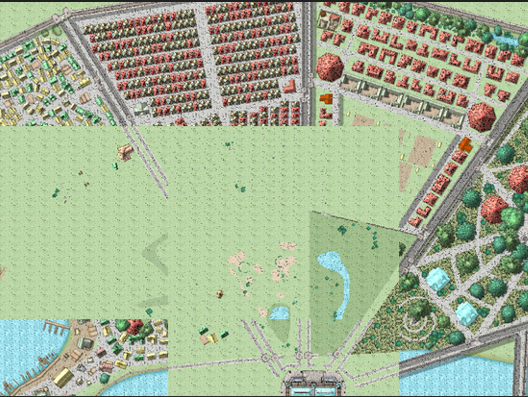

and i've tried saving it as a print to pdf and multiple pages and this happened:
i'm happy to save multiple smaller images and stitch them together in an image editor, but... these aren't really usable and i have no idea what i'm doing wrong. i've tried looking through multiple threads but i haven't been able to find anyone having the particular issues i'm having.

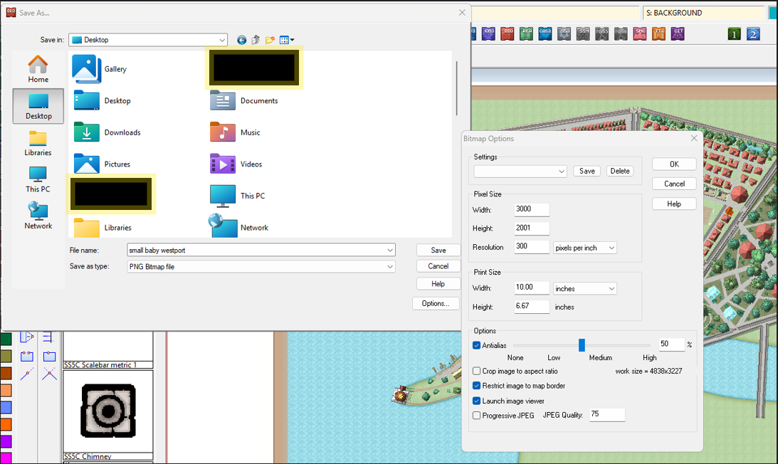

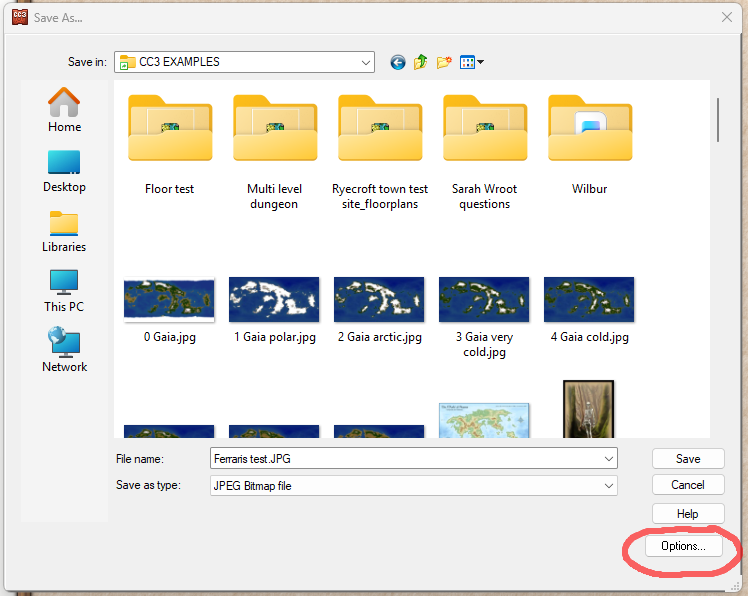

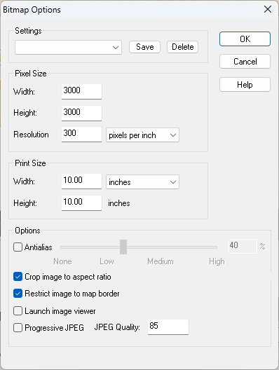

    When you Save as... and chose to save as a bitmap format using any one of the range available (png, jpeg, etc) there is an options button in the Save as... dialog.
    Click this button and adjust the options to give an image of a reasonable size and resolution.
    As an example, this setup (below) will produce a map that is 3000 pixels on the longest side, and will automatically crop the shortest side to the map border.
    You can also use antialiasing if you wish, but be aware of the work size if you do. A maximum of about 10,000 pixels in both directions is a general rule, though some have managed to export larger maps.

    so i did check those settings before i made the post, sorry if i forgot to say so in my op. i checked them again, though -
    and the result is, like. marginally better? but still doesn't show any of my sheet effects and looks kinda... peppered.

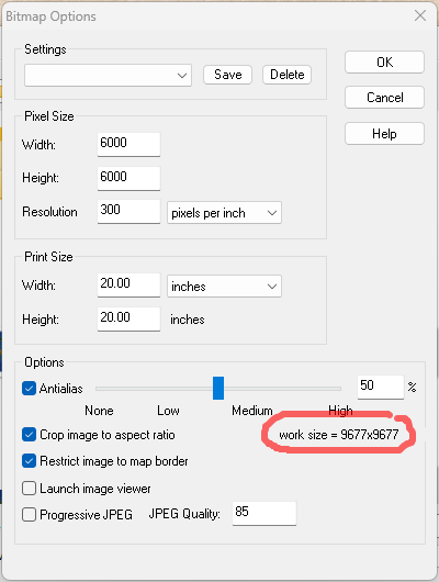

    Perhaps try 6000 x 6000?
    It will trim itself if you check the "Crop image to aspect ratio" box.

  • okay so good news is i got the large image export macro to work and i think i kinda understand it, hurrah! bad news is it still looks like this.
    which is worse.
    but i did try to increase the pixel size (my system couldn't quite handle 6000 but 5000 went thru ok) and it looks much better!

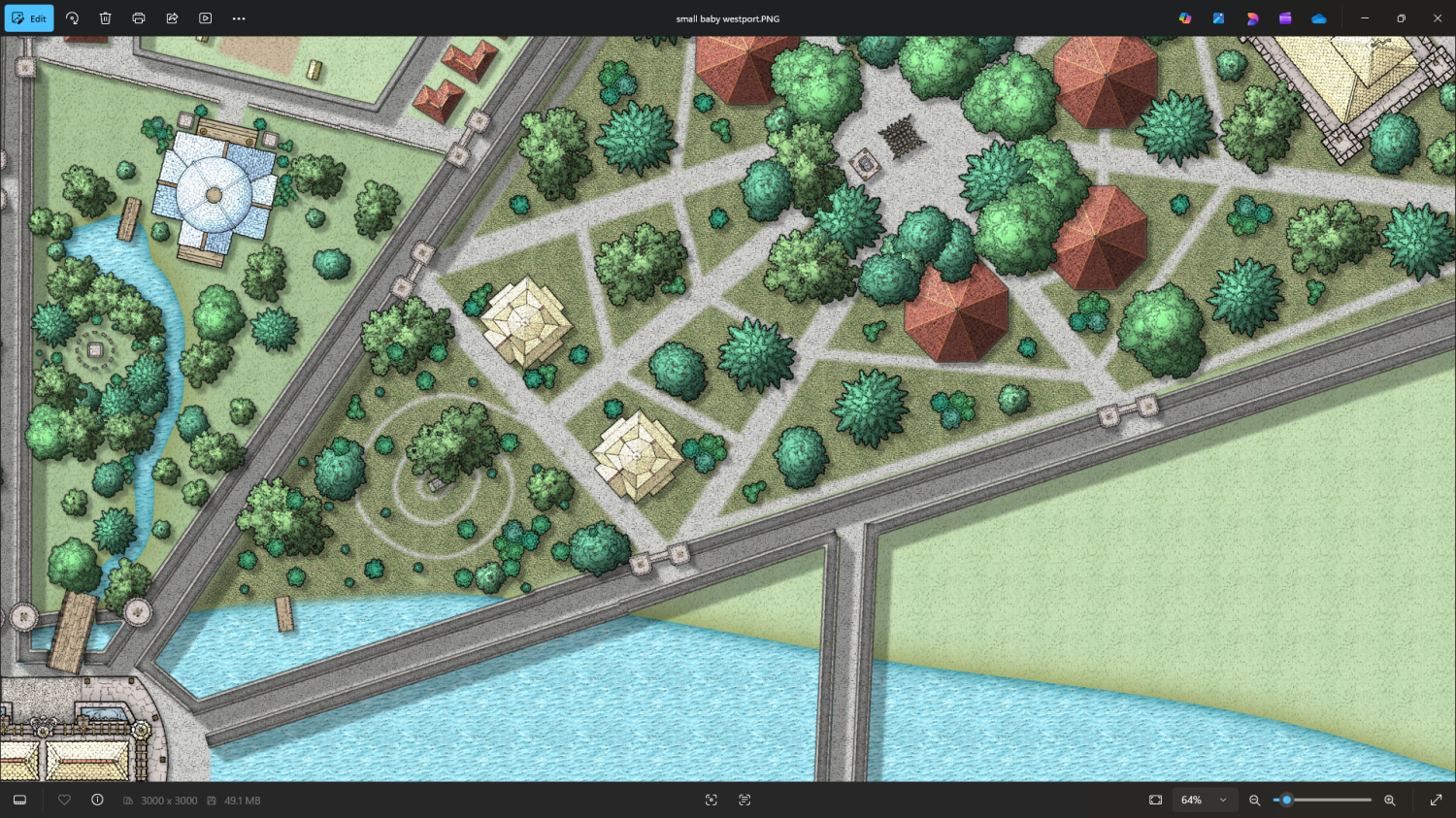

  • yeah so this is a screenshot of the map as i see it while i'm working:
    so effects should be turned on from my side of things.

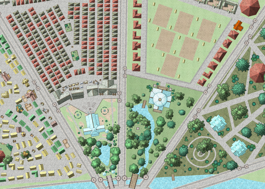

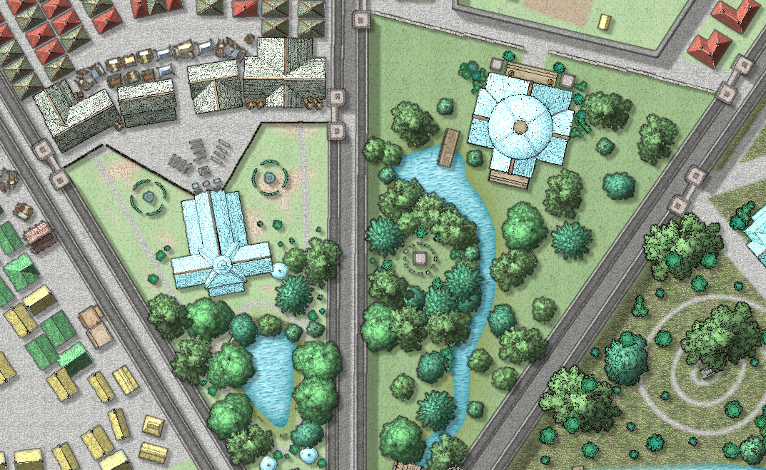

    Here's a render of a section of the city done at average resolution (3000 x 3000) with a single sheet hidden - the BACKGROUND sheet.
    As to why the sheet effects stop working when the BACKGROUND is visible I have no idea.
    I'm still experimenting.

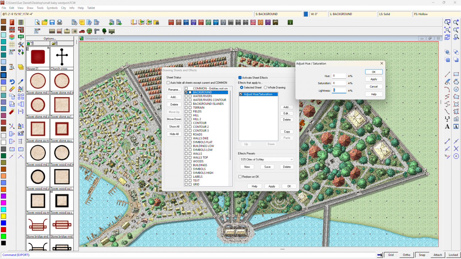

    edited 19:32 Accepted Answer
    Here's the same section with the BACKGROUND showing, but with a single effect on the BACKGROUND sheet - an Adjust Hue, Saturation sheet effect that lightens the background just a fraction. The rest of the sheet effects appear to be working now.
    Here's the sheet effect:
    Try adding it to your original and see if that helps with the effects problem.
    EDIT: Incidentally, you have a bunch of stuff on your BACKGROUND sheet that should probably be on BUILDINGS LOW, and other sheets.

    ETA: this worked! i'm so happy, thank you so much for your help!!
