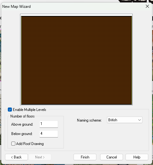

    I strongly recommend creating a map with as many levels as you need. Yes, it's multiple maps, but they are hyperlinked together so you can switch levels with a click.
    You can set this up in the 5th dialog of the New Map Wizard:
    Check the "Enable Multile Levels" box and set your numbers. Make sure that you have the correct Naming scheme selected, as this will be reflected in the resulting maps. Then name and save your 'map' (which is actually a collection of maps) in an appropriately named subfolder of the folder where you keep all your maps. That makes it easier to move them all together - by moving the folder around.

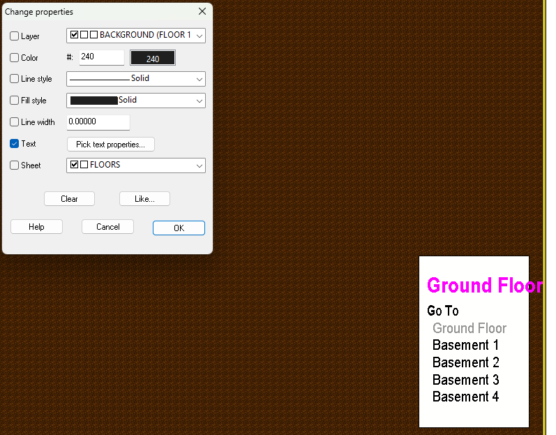

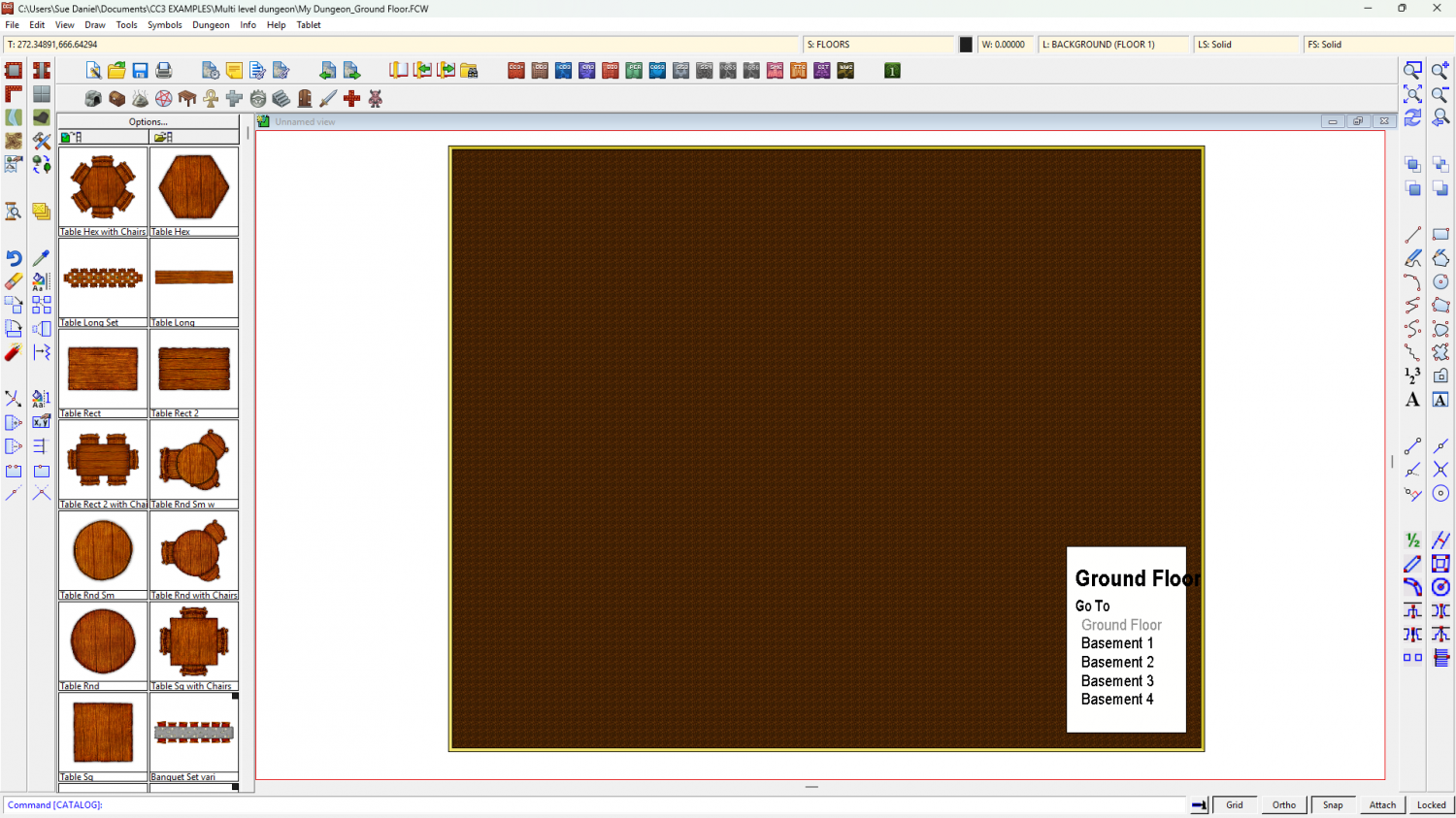

    Here is the main map I just created in a new subfolder of my CC3 EXAMPLES folder, called "Multi level dungeon". The list in the box shows all the other levels - hyperlinked to this main map.
    (Please ignore the font issues I seem to be having. I think some of the fonts are possibly missing from my PC).
    You can change the font and size of the items on that list if you want using Change Properties, and then picking the Text - Pick text properties... option in the dialog.
