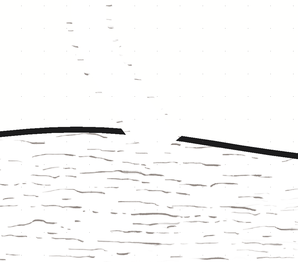

I am trying to do a John Speed Version of a Colony Map in the Southlands. For that I want to hijack the Texture of CA110 for the water bodies (Rivers and Sea). Sea went smoothly. However for the River only the outline was replaced. (Probabgly because the River is "open". I want to keep the black outline and the general river behaviour (overlapping rivers/sea gets merged together), but want to fill it with the texture (like in CA110) Waht do I need to do? Screens attached.

  • Aha! Note: For rivers to have a texture, use the OUTLINE definition. Reason: A river is basically a line. You need to draw two lines over one another. One is the outline of the river (that is the normal one) and the other is the interior. Now the outside (the actual river) is drawn Below the outline. To have it show up correctly you need to switch outline and interior in your head. It is the other way around than a normal polygon. Like the sea. Still with me? So if you assign a texture to the outline and the river line width is larger than the outline width than you have the correct appearance. And yes. I am currently a little "wuschig" as we say in Germany. But it works. Yeay!

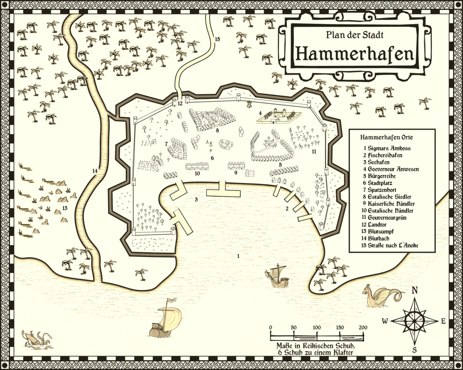

  • Sooo... Here is the result. Wirdly enough, the blurr doesn't seem to blur that much, the maps looks kind of crisp. BUUUT I do not have time, because I need ot prep the game until tomorrow... But I would have liked to show what it was about.
