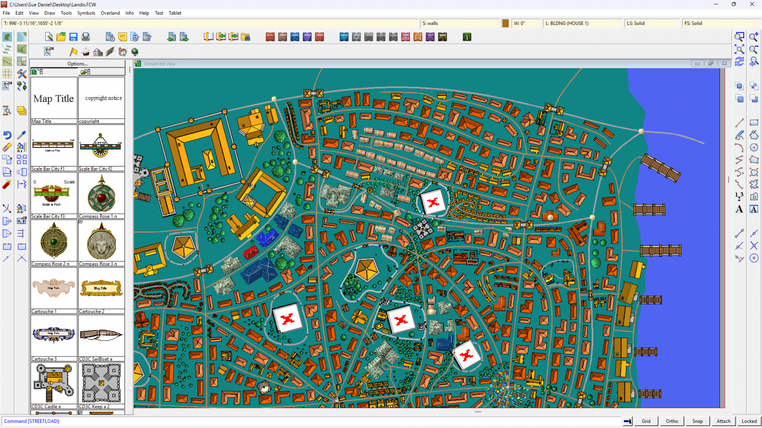

    This is one of the evil cities, and it wont load in CC3+ but will in CC3, its one of a few cities, and your welcome to that city!
    Thanks :)
    I managed to open it in CC3, but it did take a lot longer than usual. I've run FFIX on it to speed up accessing the bitmap textures, but most of these buildings are vector so it might not do that much to improve the situation.
    It might take about a minute to open for you. Be patient and see what happens.
  • the X areas are towers the actual location for them was never repaired just as an FYI, to get CC3 to adjust the FFIX, what should II do since getting the error.

    The map seems to be triggering a redraw loop.
    The first thing you need to do when this issue occurs is to make CC3+ break out of this loop. Often, the best solution is to just have it display a dialog. Start loading the map, you'll notice that the cursor turns in to the spinning circle, and the title bar of CC3+ will alternate between showing and not showing a "(not responding)" at the end there.
    Now, just click on the sheets and effects button in the left toolbar. You'll not get an immediate response, because the program is working, and it can be worth clicking a few times just to make sure it is picked up (but you do not need to hammer your mouse button or anything). After a few more redraw loops, the dialog should show, and you should also be able to see your map fine in the background. Now, close the dialog, then run the FFIX command. That should upgrade the paths of all those CD3 houses in the drawing, and hopefully put an end to the loops too.
