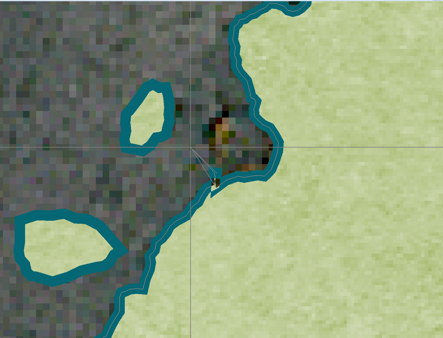

Been a while and a bit. I am re entering ProFantasy after some absence due to life drama. The map I'm trying to create shows three node spikes or miter nodes. I have tried several methods to edit but the whole coastline ends up being selected and turns pink. I have to assume I'm clicking the wrong spot. Can anyone take a look at the image and provide any guidance. Alternatively, is there a YouTube video link that goes into detail and demonstrates how to correct this? I assume explode coastline nodes or some other method.

    Perhaps try the SIMPLIFY command on both the coastline and the Land polygons (there are two identical polys there on different sheets). Read the command line and when prompted for a Simplification Distance start with 1. If that takes out too much of the detail CTRL+Z for undo, and try again with a smaller distance.
    Or, since that flaw is caused by the width of the coastline entity as much as the proximity of the nodes, hide the COASTLINE sheet and use a blue glow on the LAND sheet instead.

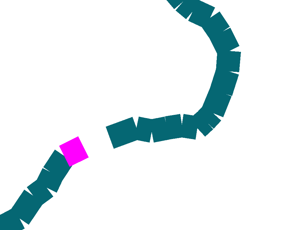

    Thanks for the advice. I will try that. I have noticed if I explode the countour (blue line) I get a number of blocks which I can delete individually. Once I delete any blocks I am not sure how to remedy the gap, plus it seems the land (green) stil retains the spike shape once I unhide everything. Let me give simplify a try. I also found online that it might be possible to paint out the spike with a sea polygon but it sounded messy.

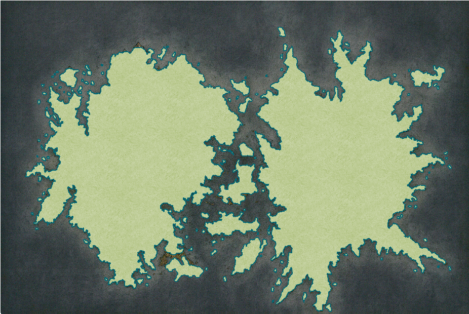

  • Here is where I am at for now.
    Still some minor changes to make. Thanks for all the help.
