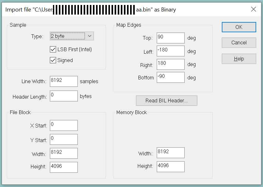

    In FT3,
    File>>Save As... and pick "special MDR" as the file type. Use 8192 (or whatever you want your width to be) and check the 16-bit integer checkbox. After some churning, you'll have a binary raster in the Plate Caree projection (1:1 lat:lon equirectangular) without any header or data, 16 bits per pixel, Intel byte ordering, width samples wide and width/2 samples high.
    In Wilbur,
    File>>New with width=8192, height=4096 (half the width); top=90, left=-180, right=180, bottom=-90
    File>>Import>>Image Subsection. See image because there are too many parameters here because the image subsection tool does too many things at once.
    File>>Save As with "HF2 Surface" as the type. There are potentially many types that will be usable, but I tested with HF2.
