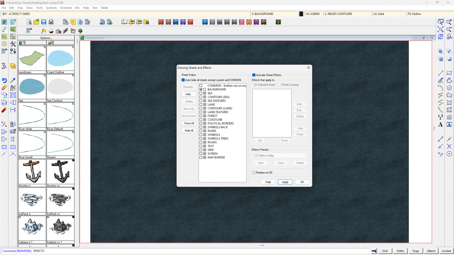

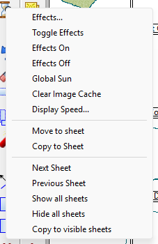

    Two ways (bulleted instead of numbered here because I can't seem to get the numbered list to work right now):
    • In the Sheets and Effects dialog there is a checkbox above the list of sheets called Auto hide all sheets except current and COMMON. Check that box and hit the Apply button bottom right. When when you click the next sheet down the first will hide itself, and so by working your way down the list you can see if a sheet has something on it. Be careful not to delete a sheet called SCREEN if your map has one. That sheet contains a white polygon around the outside of the map that masks anything that continues outside the edge of your map, like a symbol or the tail end of a road or river - or probably in your case, hex halves.
    • With only the BACKGROUND sheet visible (but no check in the Auto hide... box) right click the Display Speed Settings button (the hourglass on the left) and you will find a block of commands at the bottom of the list that will help you do the same thing. It's slightly less efficient since you must right click the button to get the menu each time you want to look at the next or previous sheet. The advantage, though, is that you don't have a huge dialog blocking your view of the map.
