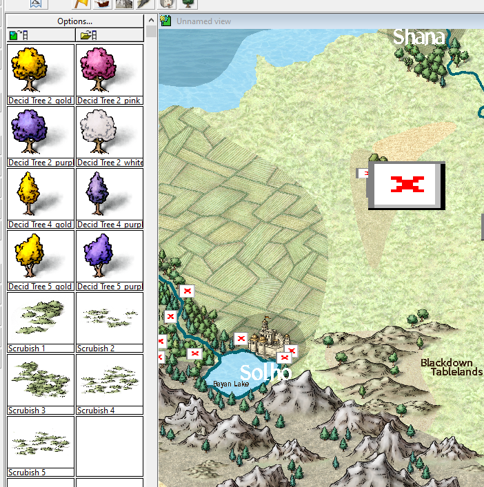

Red Xs on an older map
edited November 2025 in Community Support
EDIT: I found how to remap the symbol paths in the Symbol editor, so this has been resolved
I re-opened a map I made a few years ago and I'm getting these red X symbols. I've brought in the custom symbols into the symbol selector on the side but the Xs aren't resolving.
What am I missing?
  • RalfRalf Administrator, ProFantasy 🖼️ 18 images Cartographer
    Open Symbols > Symbol Manager, EDIT one of the symbols showing a red X and use Info > List on the red x rectangle.
    That should show you the location and image CC3+ is looking for in the map. Copy the missing images there, restart CC3+ and the symbols should show again.
    If you can't resolve it, post the FCW file of your map here, so we can take a look.
