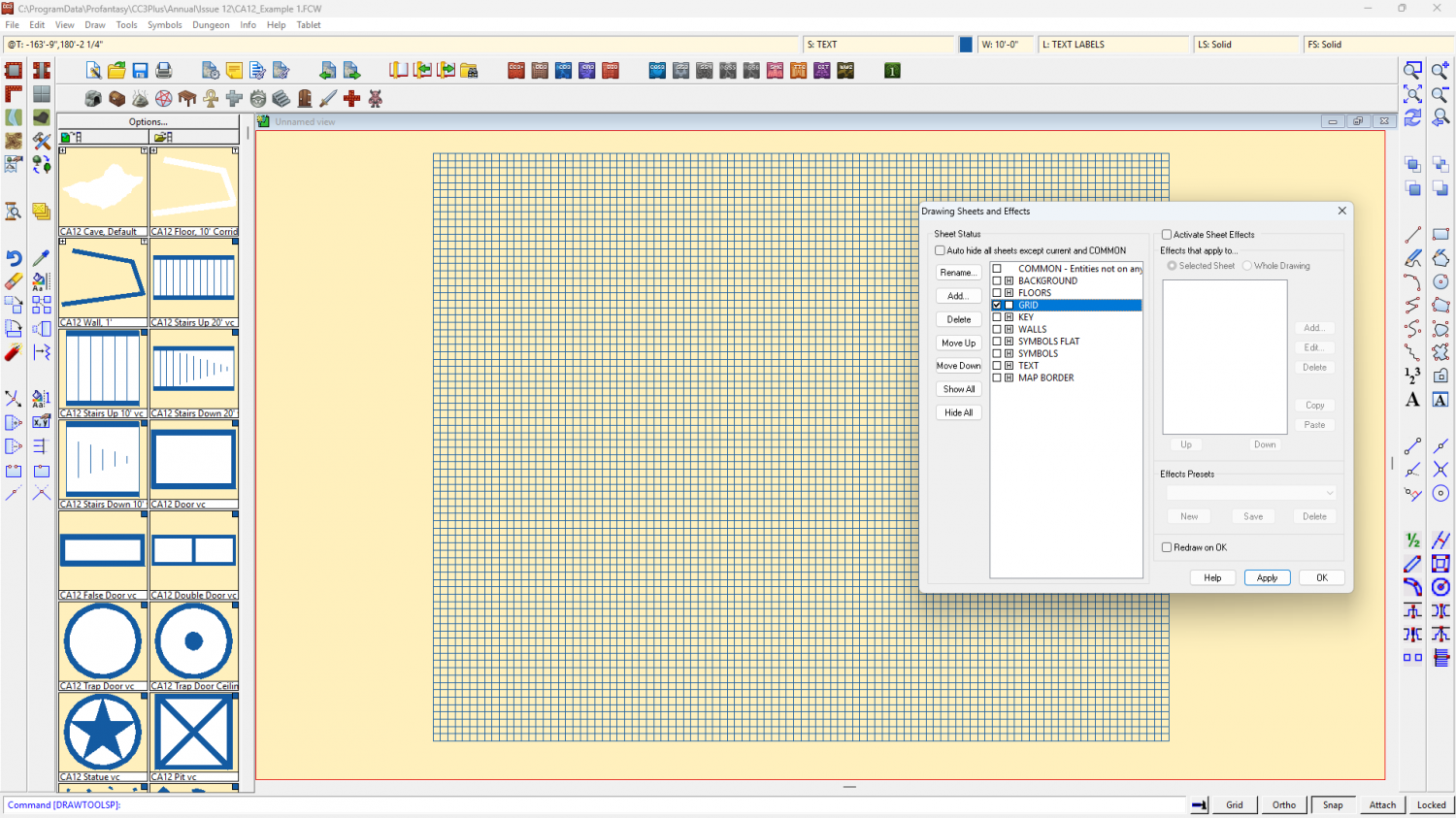

    I have a modified colour palette, so it's not the same blue on my screen.
    There's a blue grid that covers the map on that example map. Here it is with everything else hidden. Because it's the same colour as the background you can only see it when a white floor is drawn behind it.

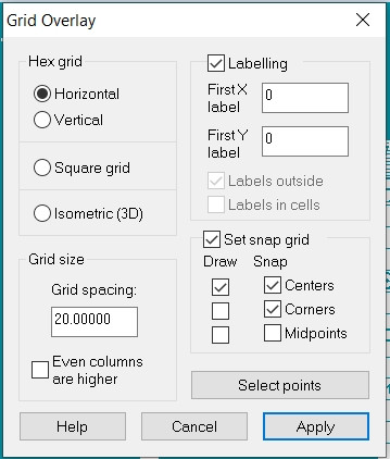

    Then open the drop-down menu Draw => Hex or Square Overlay... which brings up this pane:
    Check the "Square grid" radio button, set the "Grid spacing", and then decide if you want labelling per square or not (if not, just uncheck the "Labelling" box), and decide if you want to add a new snap grid for your grid lines.
    You then have two options.
    The "Apply" button places the grid across the entire map within the Map Border. For this blue style, that usually works fine, because the grid is located to appear above the white floors Sheet, but below things like the map symbols and text Sheets, so the unwanted part of the grid will blend perfectly into the blue background and not be seen.
    Alternatively you can choose "Select points", and then use an existing snap grid - or by eye if you're very confident about doing that - to click once to start placing the grid. Then expand the grid over your map, to fit exactly where you want it to be (even if that's just a room or two). Once the other corner's in the correct spot, click again to complete placing the grid.
    As the information pane shows, you can alternatively add a hex grid or an isometric one, if you prefer.
