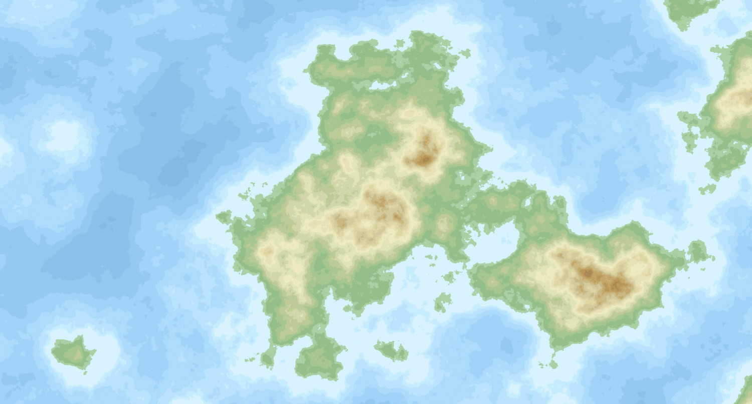

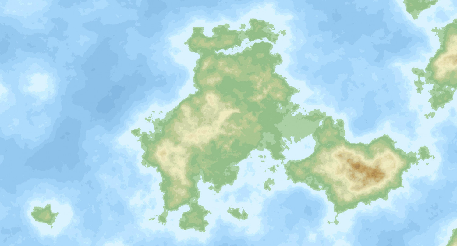

    I've actually been experimenting with the Remap Altitudes command on a world I generated for the purpose and I'm pretty happy with how its performing. I generally feel that FT creates too many high altitude areas and to bring these all down using the usual method takes a long time and feels tedious to me. Generally what I'm doing is looking at a landmass, deciding where I want elevation to be, and then creating a series of selections where I use the tool at the 1.1 setting. The first use will remap the altitudes in the selection at a lower altitude. I'll repeat this on the same selection to bring it down to sea level. When I see sea appearing I'll hit the undo to keep everything above sea level. Then I'll move on to another area and do the same. Typically I'll end up doing 3 - 5 in the same area. Once all of that is finished, I'll create another selection that covers all of the former selections and do a global smooth between 3 and 10, depending on what's needed, to get rid of the unnatural looking edges of the selection. In general, I will use a combination of this technique and time-honored lower land clicking to get things where I want them. The two pictures above show the unsculpted version and the working version I have right now, to give yu a sense of the results.
