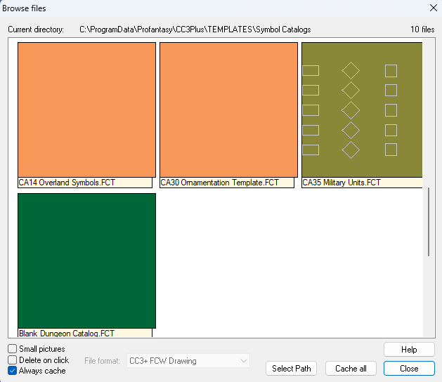

    The fastest and easiest way to create a new catalogue from existing symbols is to create a new file using the New Drawing Wizard. Pick the Symbol Catalogs group and "Pick a pre-defined template".
    Hit Next, and pick the most appropriate catalogue type, though most of the time the simple Blank Dungeon Catalog.FCT will do.

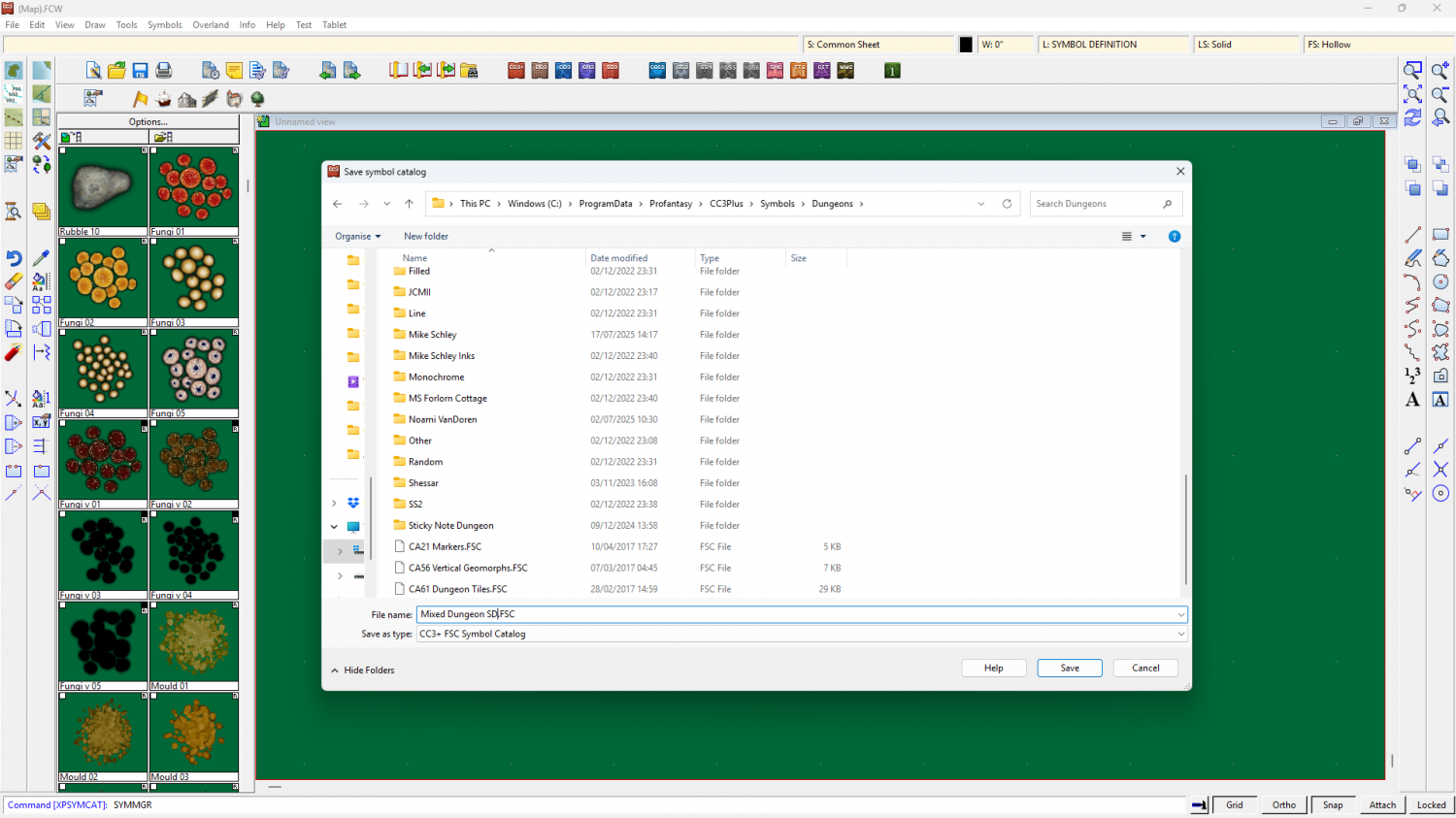

    Once I've finished adding the symbols I can then open the Symbol Manager again and select all the symbols in the Symbol Catalogue and use the Save as catalogue button at the top to make my new mixed style catalogue.
    I recommend saving the catalogue in the parent folder of the basic style type. For instance, if I have a catalogue of mixed dungeon styles I would save it as "Mixed Dungeon SD.FSC" in the Dungeon folder.
    Once the catalogue is saved you can discard the drawing you were using without saving it. You have the FSC you wanted, and if you need to add more you just open the FSC file.
