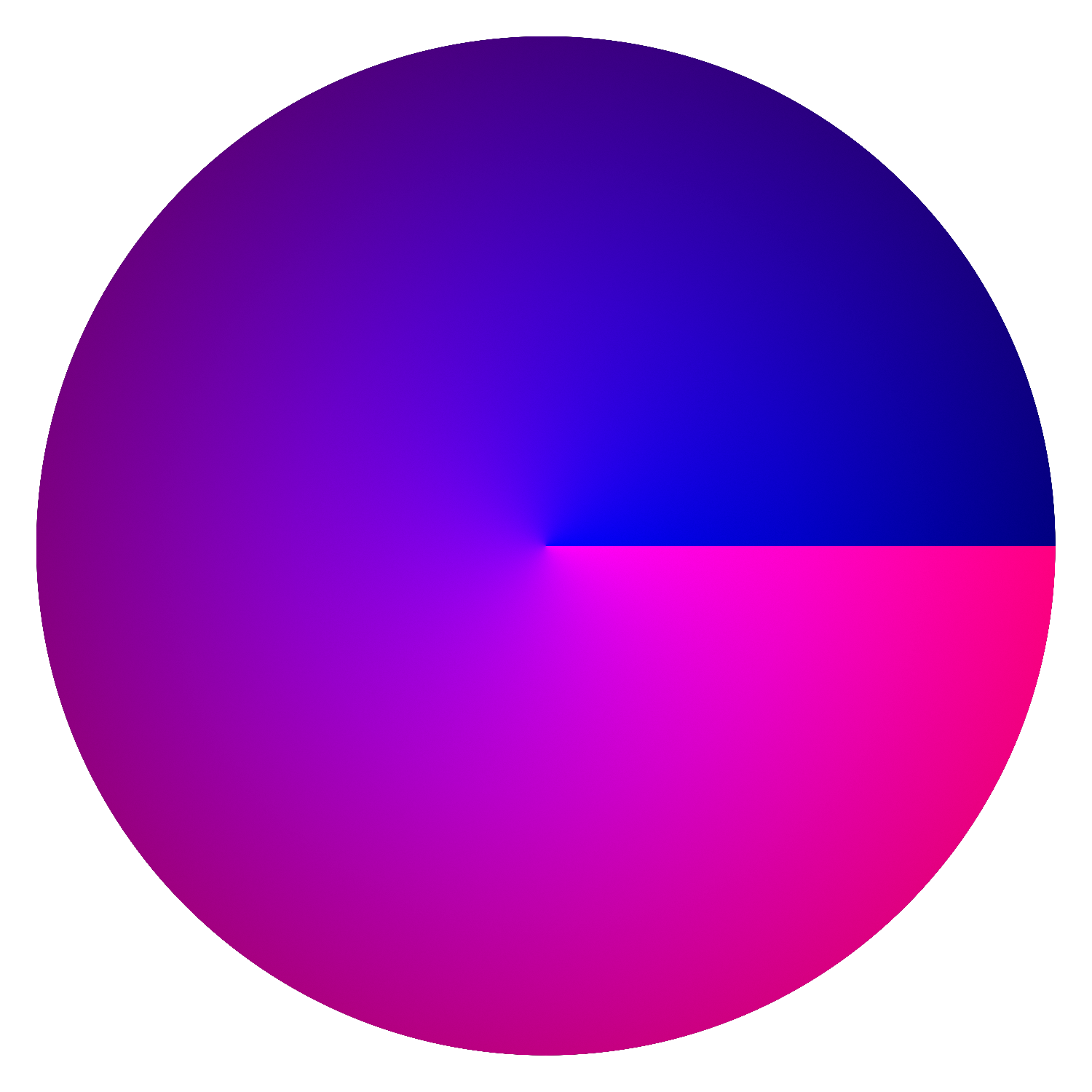

I used Blender back in the day, but you can do the same in a bitmap editor with radial and spherical gradients.

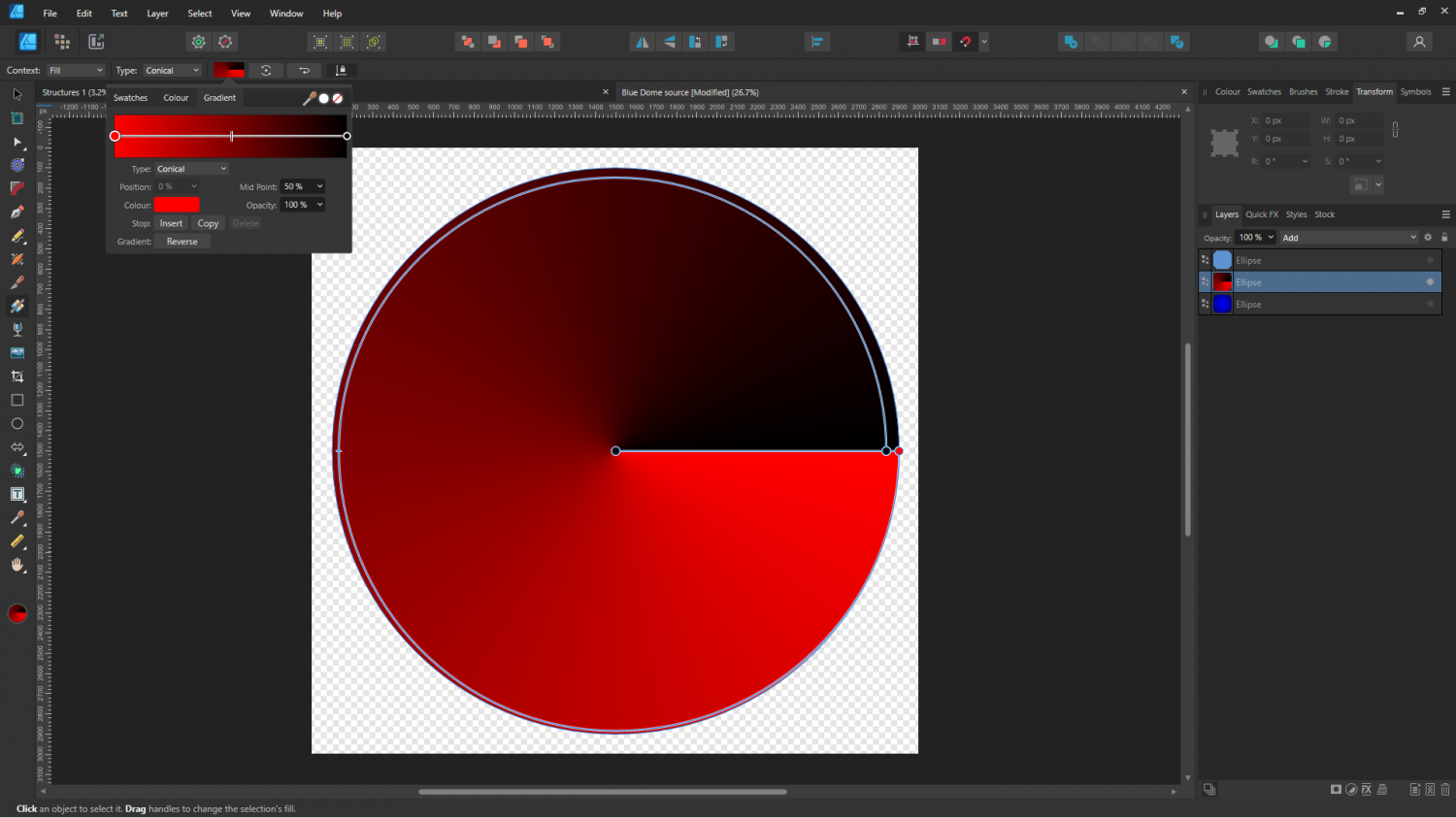

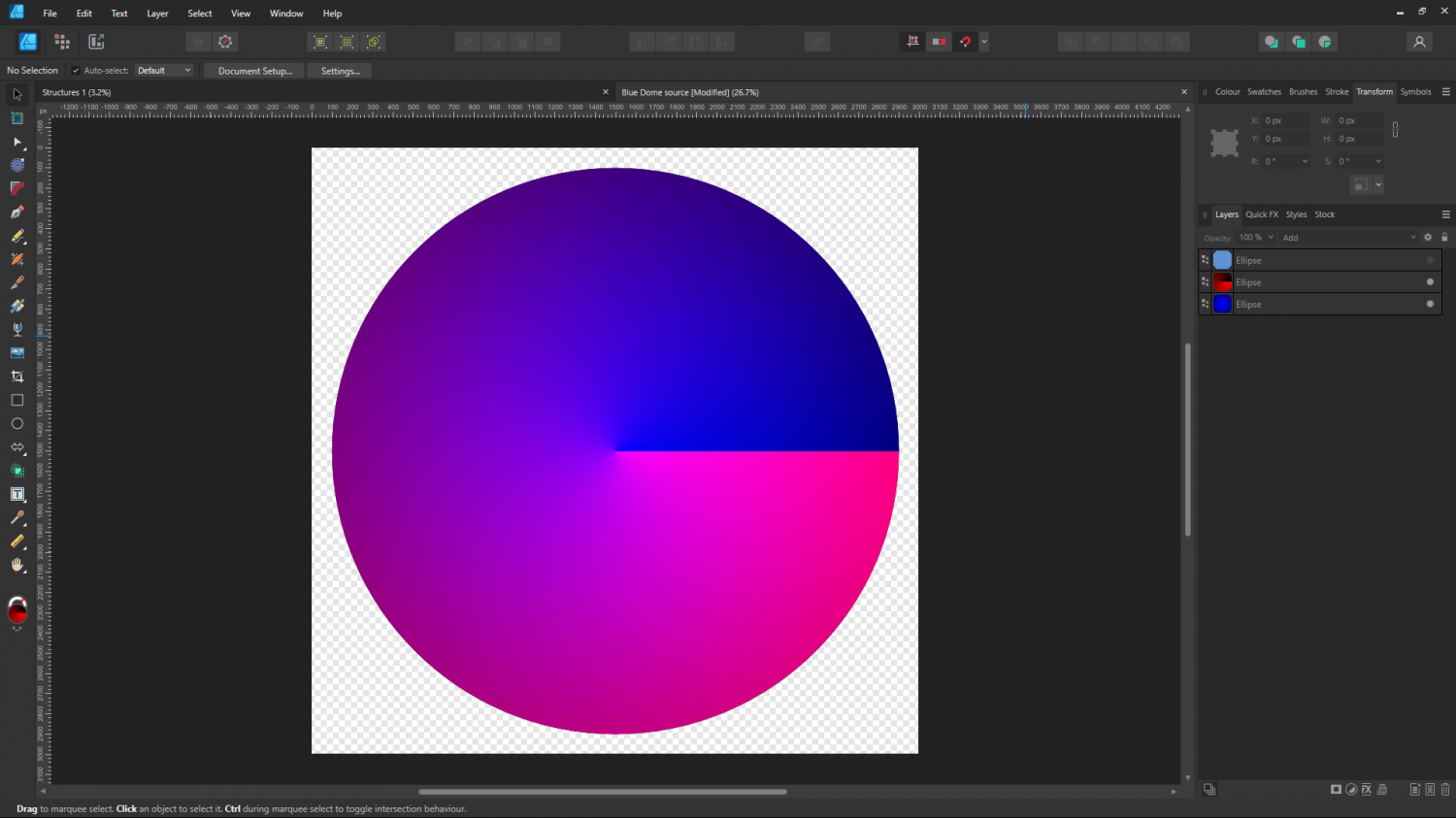

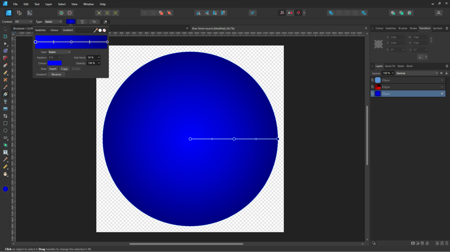

These are the 2 layers used for a dome shader in Affinity Designer - 2 gradient shaded circles.
The blue element is the pitch of the roof, created with a spherical gradient. The brighter the blue is the more flat it is, so the top of the dome is very bright blue (255), while the base of the dome is very dark (128).
The red element is a radial gradient from black to red, like this:
The red layer is 'added' to the blue layer using the Add blend mode setting on that layer, so that where the red is black nothing is added.
I think I may have uploaded this before, but here it is again if you want it.
I have added the necessary 1 green to the blue layer, so if you use this png as part of a map file it should also work as varicolour.

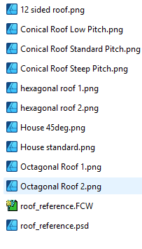

As promised here are my reference files for easy access to the different roof map settings

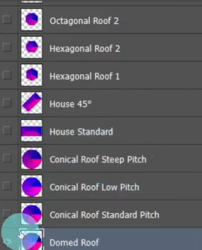

I would love to get the steep and not steep conical 'domes' as well, it you have them , either @Loopysue or @Ralf
What shape are you after, exactly?
As a dome goes through all of the angles from 90° to 0°, there is no such thing as a steeper or less steep dome (a cone has a constant angle). You can have only a section of a dome that doesn't start at 90° - for that simply take only part of the dome image, basically a smaller sircle with the same center, instead of the whole circle.
I actually meant a cone - like a witch's hat. I noticed you had them saved on the photoshop program you used.
They're in the zip. This is a list of the files included:
