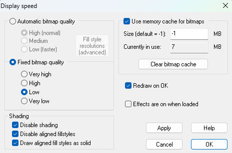

The display speed setting is set to the default -1

In addition to reducing the resolution, you could also try 1 or more of the 3 options available in the Shading panel of the Display Settings dialog.

I did try the disable shading, but had no idea what the other two did/do.

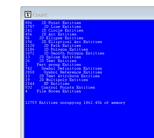

So yea, I have this issues with my Undermountain map. It's a bit larger, 20795 entities, 2475k of memory.
