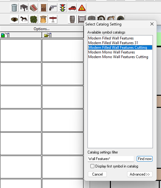

Symbols Missing, Floorplans>Wall Features>Modern Fill Wall Feature Cutting
When I select the Wall Features icon on a Modern Floorplan template, and then select the cutting symbols the entire symbol window is blank.
I've reinstalled SS2 and the Update 28 and the problem persists. I've tried a new map and the issue persists.
Any idea how to resolve/fix?

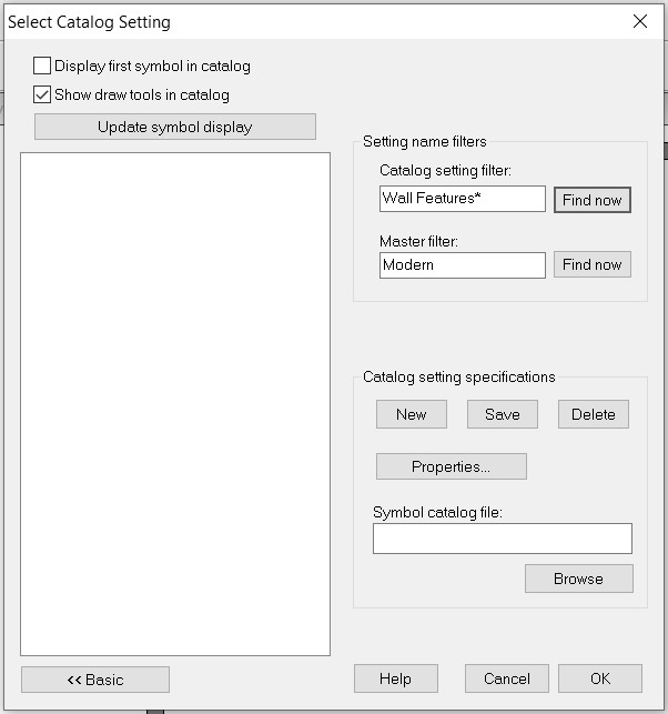

    You can navigate to the symbols manually, or you can add either of those files to your map using the drop down Symbols - Symbol Settings... option, which calls up this panel:
    In which I simply added the word "Floorplans" after "Modern" in the "Master filter" box and browsed to the correct FSC file under "Catalog setting specifications", saved that, and the catalogue now shows up when I click the Symbol Style Toggle icon.

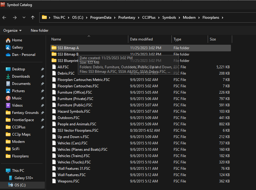

    Manually Selecting Symbol Catalog
    On the Symbols Window I select the Open Catalog icon.
    Under Symbols>Modern>Floorplans I see two catalog files for wall features. Wall Features 31 and Wall Features.
    • 31 has symbols that take on the current color background (I assume this is intentional) and do not cut.
    • Wall Features do not cut.
    Under Symbols>Modern>Floorplans>SS3 Bitmap A and SS3 Bitmap B both of the wall feature catalogs there have symbols that cut. But, these are not the same symbols as from above.
    Under Symbols>Modern>Floorplans>SS3 BluePrint Floorplans I see no wall features catalog, and no door symbols.

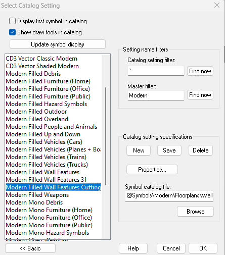

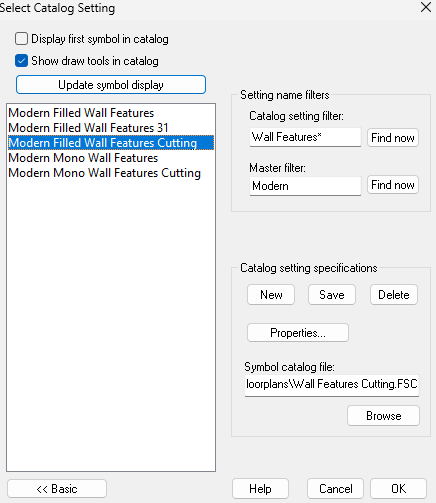

    If I use the Wall Features Icon to get to the Select Catalog Settings with the Modern Filled Wall Features Cutting selected it points to @Symbols\Modern\Floorplans\Wall Features Cutting.FSC
    Which as shown above, doesn't exist. Does it exist for you?

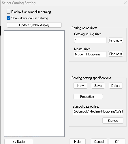

    Now when I go to Symbols>Symbol Settings... Advanced I again get the Select Catalog Settings window. If I clear the current values and put Modern Floorplans in the master filter and select Find Now I get nothing returned.
    If I just use the master filter for Modern I get a bunch, but nothing with Floorplan in the name.
