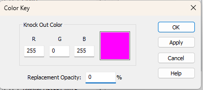

    On the second question you can add a Color Key sheet effect to the sheet the grassland is on and cut holes in the grassland using polygons of the Knock Out Color (Default magenta) where you want the holes to be. Make sure this effect is top of the list, so move it above any Edge Fade, Inner you probably have on that sheet.

    Sorry to be a pest. That colour key worked really nicely but when I click any of the Symbol Bar items like Mountains Or Cities or if I click SAVE then all the colour key sections change colour and become patches of a different colour. Its easy enough to go and change their properties back to Magenta so that they disappear again but then as soon as I click a Symbol Menu item they change colour again.
    The UNDO function does not change them back. I have to go and change all their properties again back to Magenta every time.
    Do you know what I might be doing wrong? or what I can do to make the colour key more permanent?
    In this case they are pink, previously they were brown. I am not sure where they are even getting their colours from exactly.

    Based on your description, it sounds like you may have manually changed the palette for your map, and then assigned them this color. While there is technically nothing wrong with this, the palette in CC3+ can reset to the default map palette unless it has been properly re-attached to the map using Drawing Properties after any change.
    The recommended way to deal with Color Key is to give the entities Color number 6 in the palette, this is one of the default colors that appear in all official palettes, and shouldn't change even if a new palette is loaded or the current one is reset.
