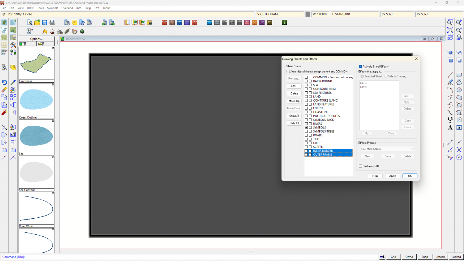

    Thinking about the first look, and glancing at the edge of my current monitor a couple of additional sheets would do it. In this example (originally MS Overland which I know all users have) I have added an INNER BORDER and OUTER FRAME sheet setup and drawn a shape on each to represent those parts. Both are on the SCREEN layer.
    The 'monitor off' background is just a grey polygon on the BACKGROUND sheet, which I moved to the MAP BORDER layer and resized to include the border and frame details for an automatic export of the whole. I then froze the MAP BORDER and SCREEN layers as is my habit.
    I hope this gives you a few ideas.

    edited June 2025 Accepted Answer
    I'm not sure what you are after with the second look.

    So your second look is a very lose general description. I would experiment with various combinations of shapes, colours and effects and see what you come up with, using sheets above the SCREEN and being mindful of where the thin green line of the MAP BORDER lies to include the decoration.
