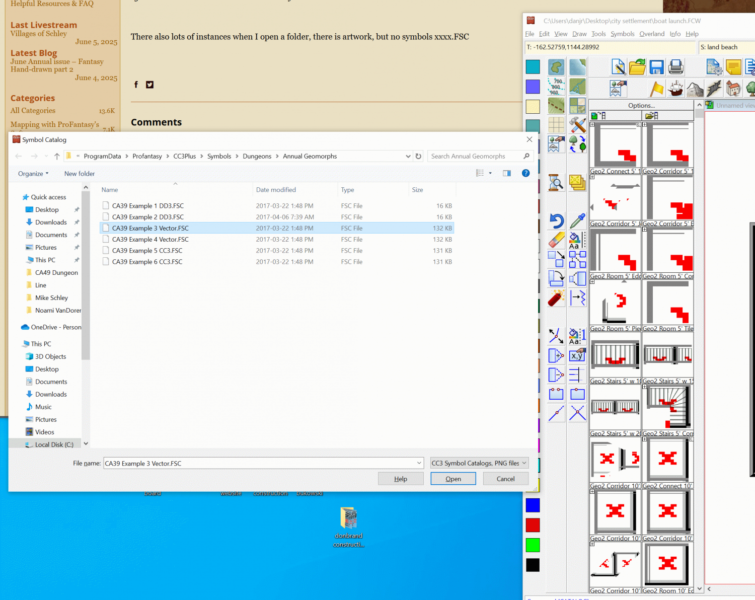

Dungeons - Annual Geomorphs - Cartographers Annual 39 Example 2 Red X's appear on the symbols???? That's new to me.

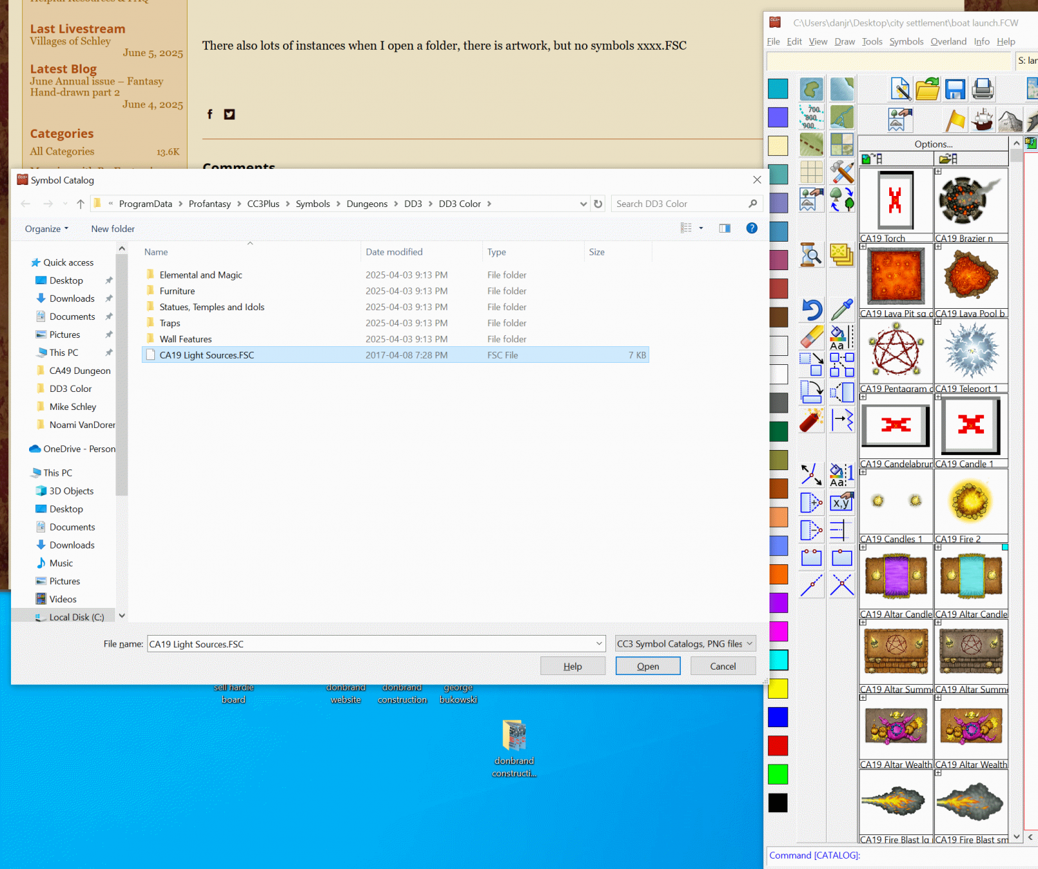

Dungeons - Dungeon Designers 3 - Cartographers annual 19 light sources Red X's appear on the symbols.
    No. No red X's in those symbol catalogs. (I assume you wrote those paths a "freehand", because while I have the catalogs you refer to, the path doesn't match 100%, like the DD3 folder is named DD3, not Dungeon Designer 3. If those paths match 100% what you have, you most likely have some custom setup there. Also, if your DD3 folder is indeed renamed to Dungeon Designer that would explain the red X's, as your paths would no longer match what is stored in the .fsc files. In any case, it seems to be an issue with your DD3 install)

  • That's my bad, I should have used the exact path, wasn't sure if I'd lose people.
    Here are images with the paths. In order from the post above.
    edited June 2025

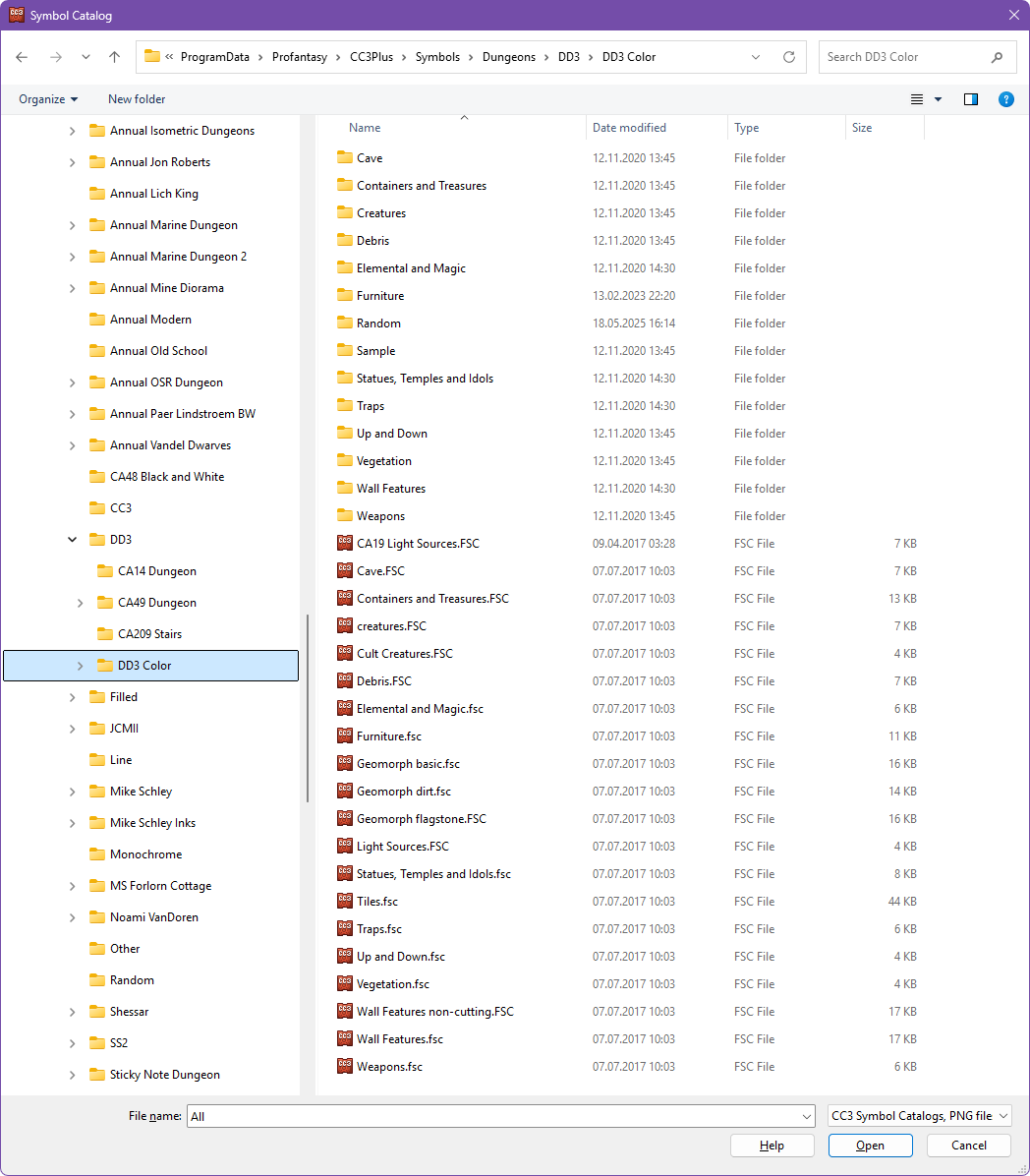

    Your DD3 installation seems to be missing a lot of stuff. Here's what that location should look like
    It looks like you maybe don't actually have DD3 installed at all just some random folders that have come with various annuals.

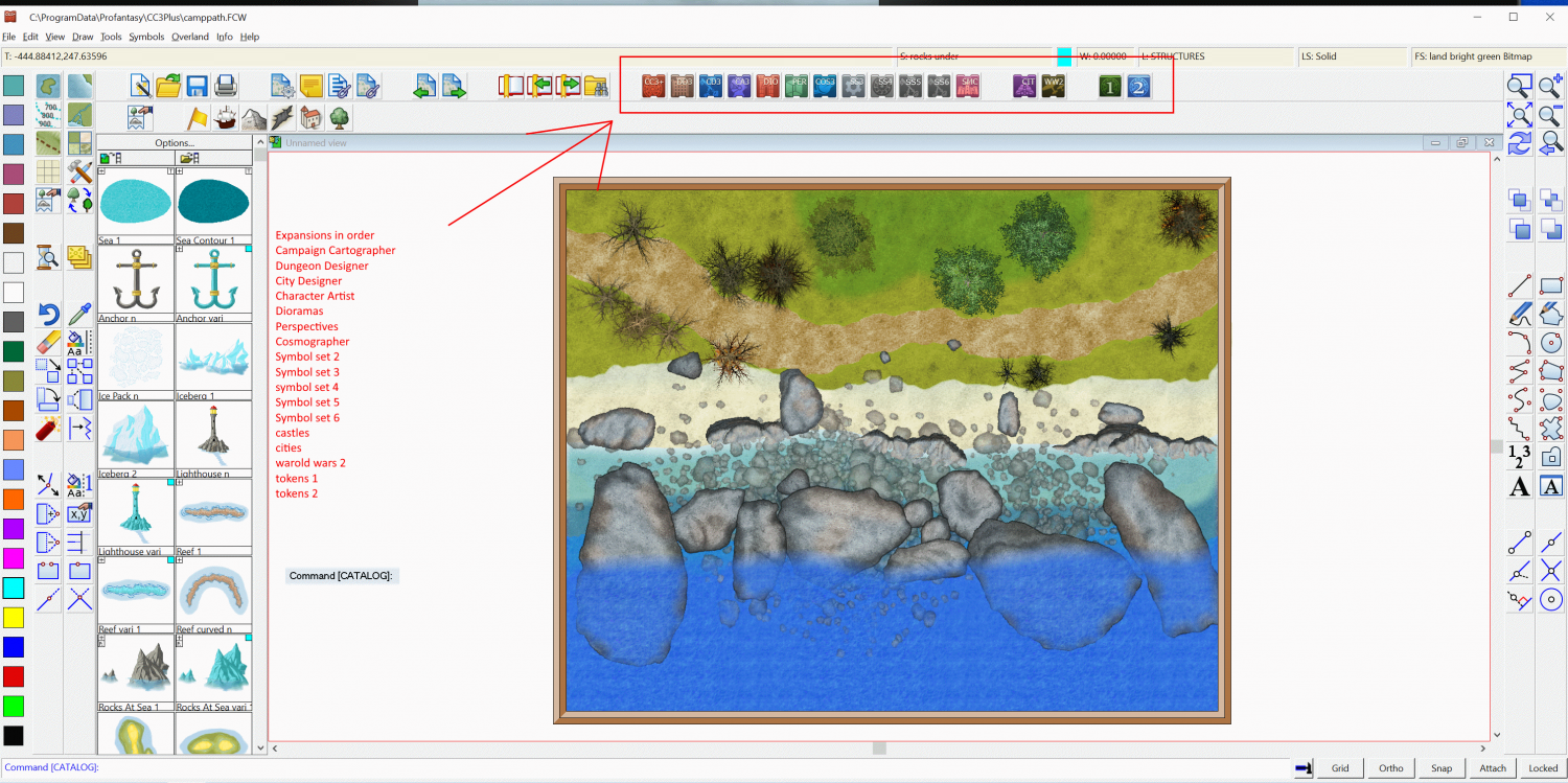

  • Hmmm that's weird. I have two copies of Dungeon Designer.
    I will re-download and see what's what. The ICON does appear on my CC3+ interface. I posted that picture just a few days ago.

  • Delete and re-install fixrd the missing pieces.
    Note that the toolbar isn't a trusted source for what's installed when it comes to DD3 and CD3. That is because the basic functionality now comes along with CC3+ itself, so everyone have basic dungeon and city stuff, which also means they need the icons to switch to the relevant menus.
