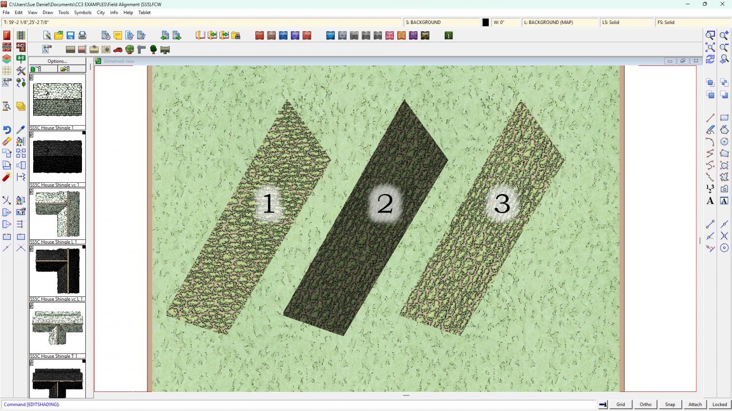

One of our viewers asked if it was possible to align the field fills with the fields. Yes it is. Some styles have field drawing tools that do this automatically - styles like the Ferraris Style and Darklands City.
The three stages look like this, where field number 2 shows the roof shading automatically applied by Shaded Polygon (Angle by Edge).
If you want to edit your field use Explode just once to return it to it's former state.
This is very helpful, Sue. I only use this rarely, and always end up scrabbling around trying to find what the thing is I need to get rid of the roof-shading effect! Now I just have to remember where this was posted next time I need it!

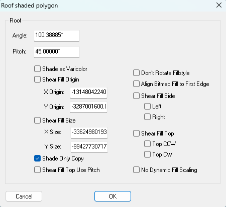

Note that there is no reason to go around remembering the EDITSHADING command from step 3, simply using Numeric Edit
on the shaded entity will do the same job.
I didn't know about that one. Thanks Remy :)
