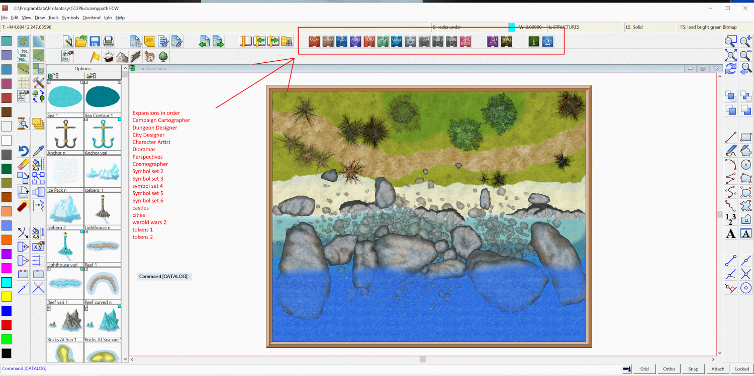

Put up a screenshot of your program running so we can see the icons on the top bar.

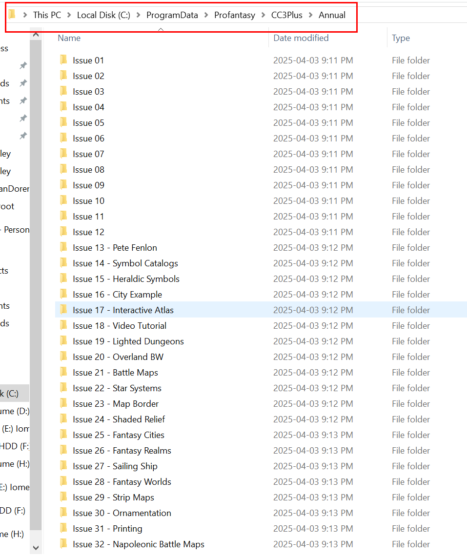

Here is how your Campaign Cartographer 3+ should look.
Symbol Set 1 annd 2 are built in.
If you have it correct, all the annuals will appear here.
