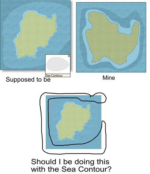

After drawing the land and the shallow water, I am attempting to draw the Deep water using the "Sea Contour". My question is does this work the same way as the shallow water? When I do it the dark water is where the normal sea water should be, instead of being on the outside section. Does this mean that I should go around the map and then go back around the outside of the map, almost making a U-shape to achieve this, or is there a way to invert it? I seem to be misunderstanding something.
That is correct, Goblixie - draw the shape as you have indicated in the bottom drawing.

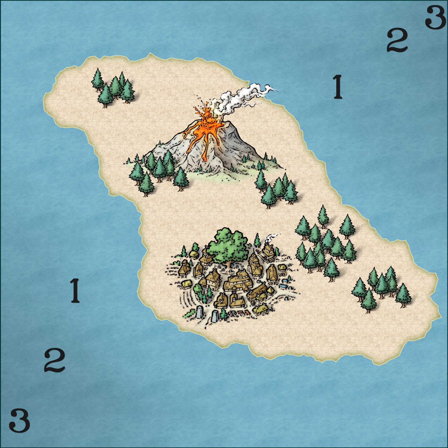

If you want to make it even darker, you can create a Sheet on top of the Sheet of Sea Contours 2, 3, 4 etc and control the edge fade inner. This way they won't be superimposed badly.
