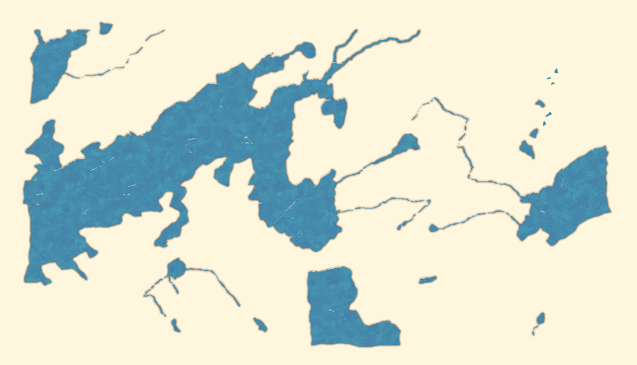

A is before I have done anything apart from hiding all other sheets.

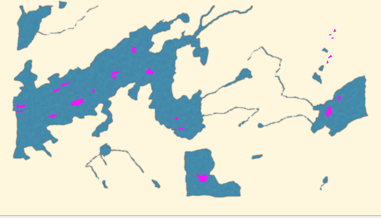

B is when I have selected all on the WATER (ALL) sheet with the islands and tiny lakes visible

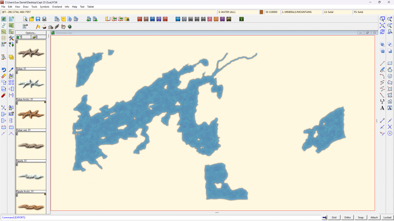

C is just after I have changed the colour but not refreshed drawing area. you can just see some of the outlines of some of the islands

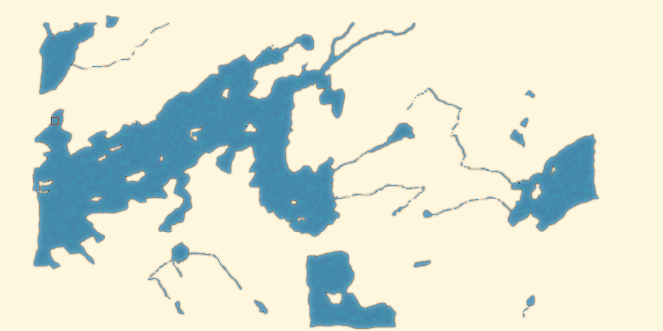

D is after refreshing the display
So the islands are vanishing?
When you change the properties of the water you are also changing the properties of the magenta cut-outs. They need to remain unchanged.

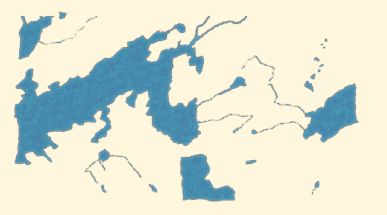

Is this what you wanted to do?
I selected by fill style and changed one water fill for the other one.
