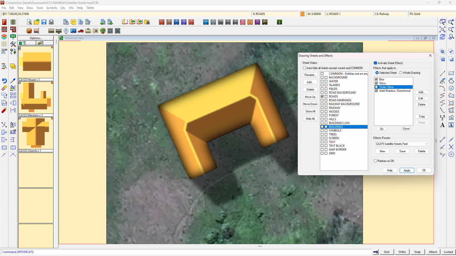

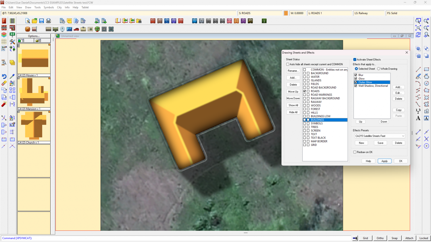

    I'm not seeing an orange edge on this test map I made. But I do have an Outer Glow effect I'm not keen on. I switched it off in the second shot.
    Is that somehow looking orange to you?
    Would you show me your orange edges please?

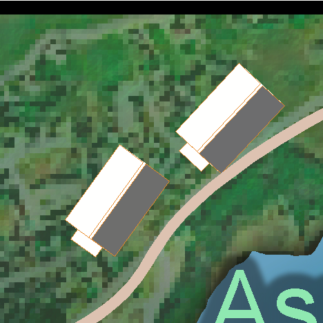

  • Here you are Sue. I’ve tried everything I can think of - even going on holiday - but nothing works. admittedly the actual size on my map isn’t 2 as shown here but 0.5 which somehow makes it worse.

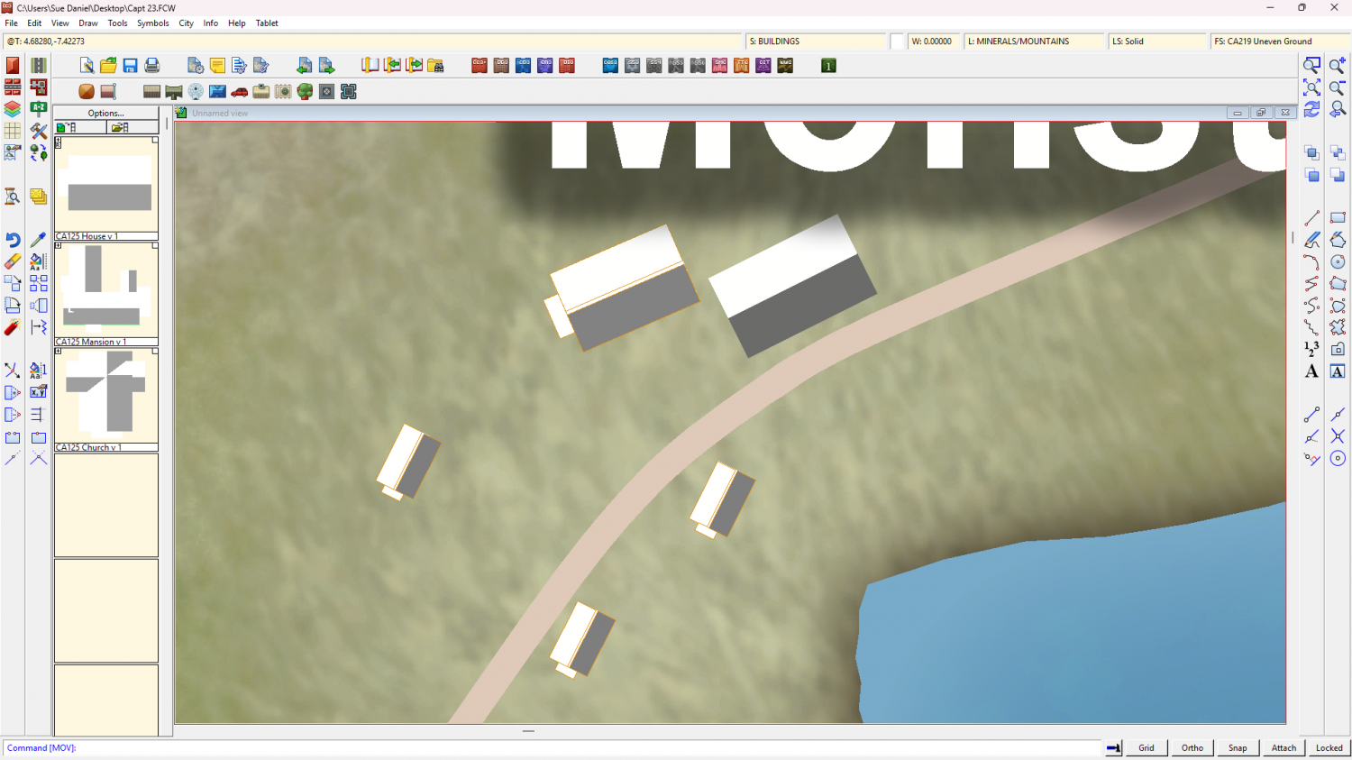

    I tried hiding various building-related layers, and changing properties, but nothing worked.
    When I drew a House entity next to the symbol I added it had no orange line, but I can't explain the orange line around the actual symbols because I can't seem to hide it in any way.
    It may be related to the fact that the symbols were designed to be 'just so' in the original city style where everything works, but they don't work well in this mixed style map, which I think was originally the overland style Birdseye Continental(?)
    It may be something you should report to Tech Support, but TS is a little thin on the ground at the moment with summer holidays taking place. Whatever the combination of styles there shouldn't be a problem like this with the symbols.
    I recommend trying an alternative source for your buildings, or using the House tool to draw your own. As you can see from the screen shot I took the building I drew is not affected.
