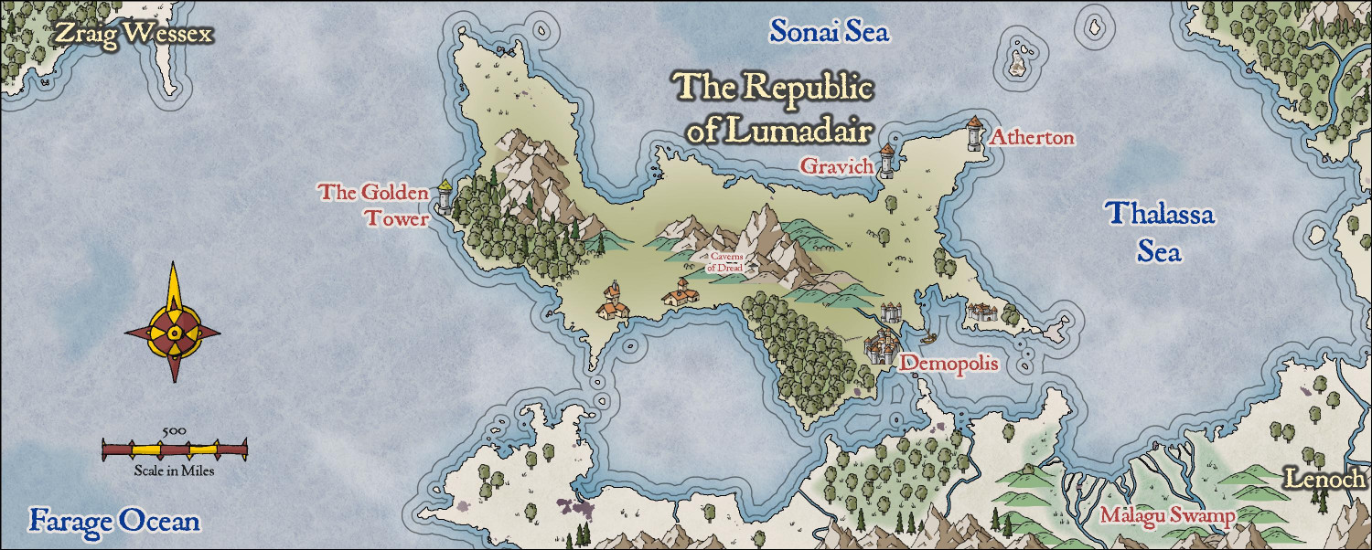

Usually I wait until Ralf has had a chance to demo new annuals in the Live sessions, but since there was no Live today because of the May Day holiday, I decided to dive in anyway. Here's my tried-and-true, oft-mapped Republic of Lumadair in the new "Hand-Drawn Fantasy" style.
I used the cutout approach for the rivers. But rather than drawing the swamp terrain around the rivers, I added the Color Key effect to the Swamp Terrain sheet and then copied my magenta rivers to that sheet as well.
It's funny how much I've mapped Lumadair, given that it isn't even intended to be the main location for my campaign world. But it is a conveniently-sized area, and once I did one map of it, I found it useful to do other styles for the same location as a convenient way of comparing them.

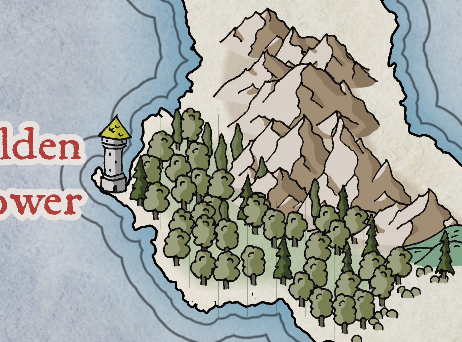

  • One weird thing I noticed: when I used the Mixed Forest Draw Tool, it didn't actually add trees. Instead, it added strange vertical lines. I went and added the trees manually, hoping that the lines were just a display thing in CC3 that wouldn't render in the JPEG export -- but they're visible on the JPEG.

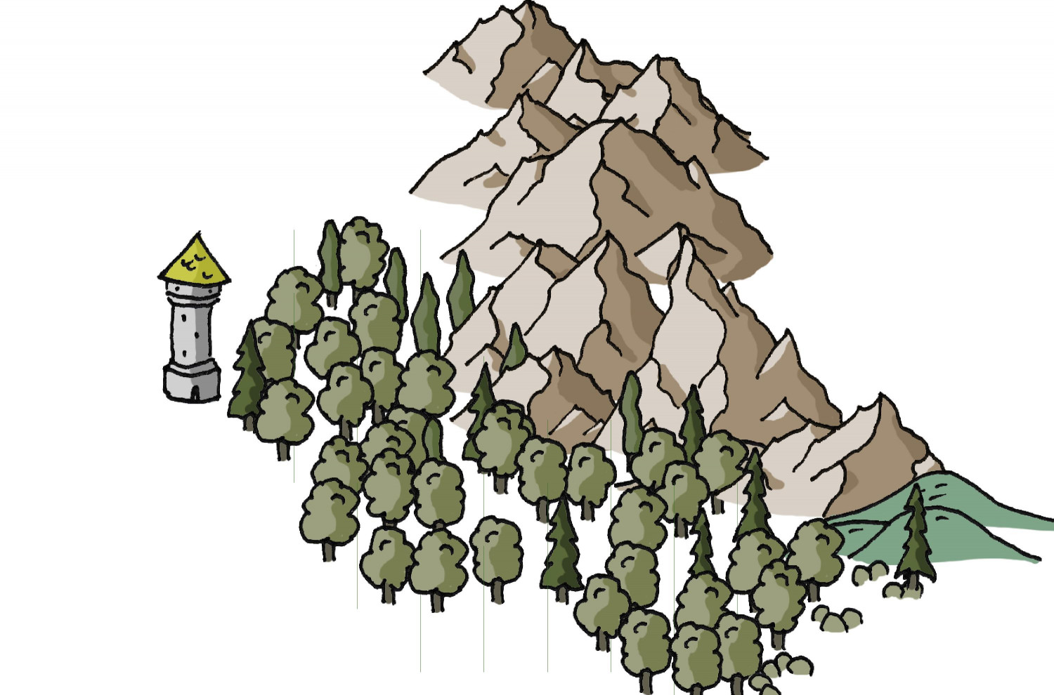

    You can see them better on this, which is just the SYMBOLS sheet -- so those lines got placed on the Symbols sheet instead of the tree symbols. It looks like I can manually delete them (just tested on one), so it's easy enough to resolve...but odd. I have a vague recollection of something like this happening in another annual, but the details are fuzzy.

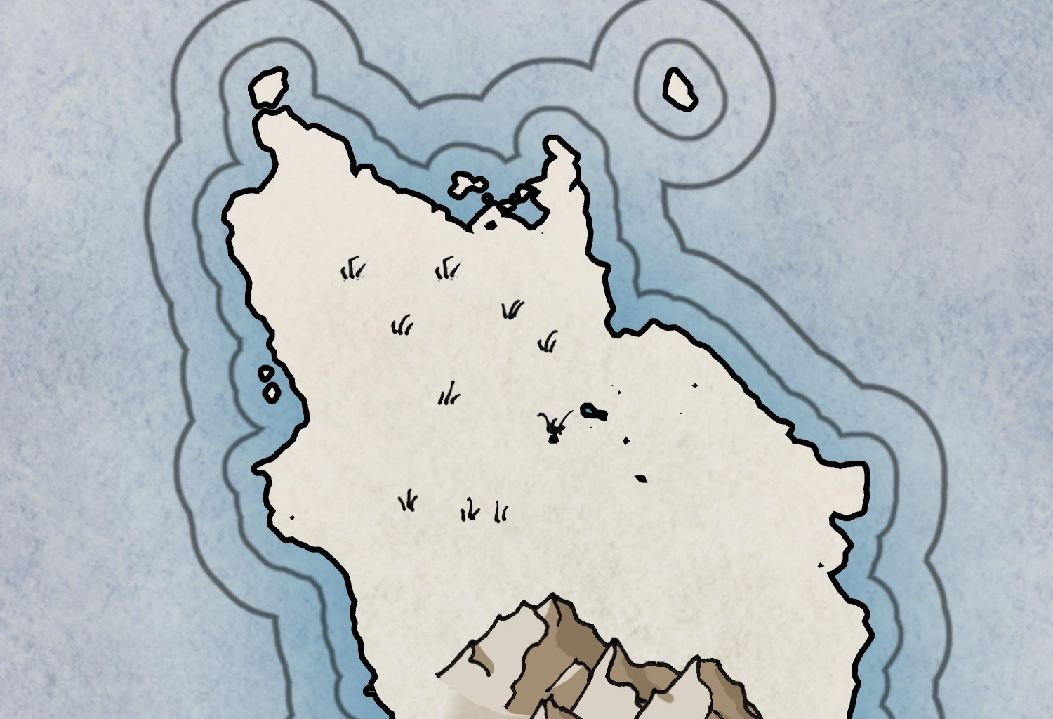

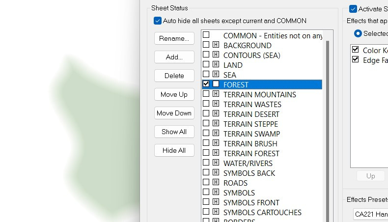

  • Yes, the lines and the fill can be independently selected (and deleted). I drew a new forest over another part of the map to illustrate it.
    Step 1 - This is the area I'm drawing the new forest. (Note that I used the Mixed Forest tool but I had the same experience with the Deciduous, Conifer, and Pine Forests.) Pointing this out to show that the grass symbols were already there, not added by the tool.

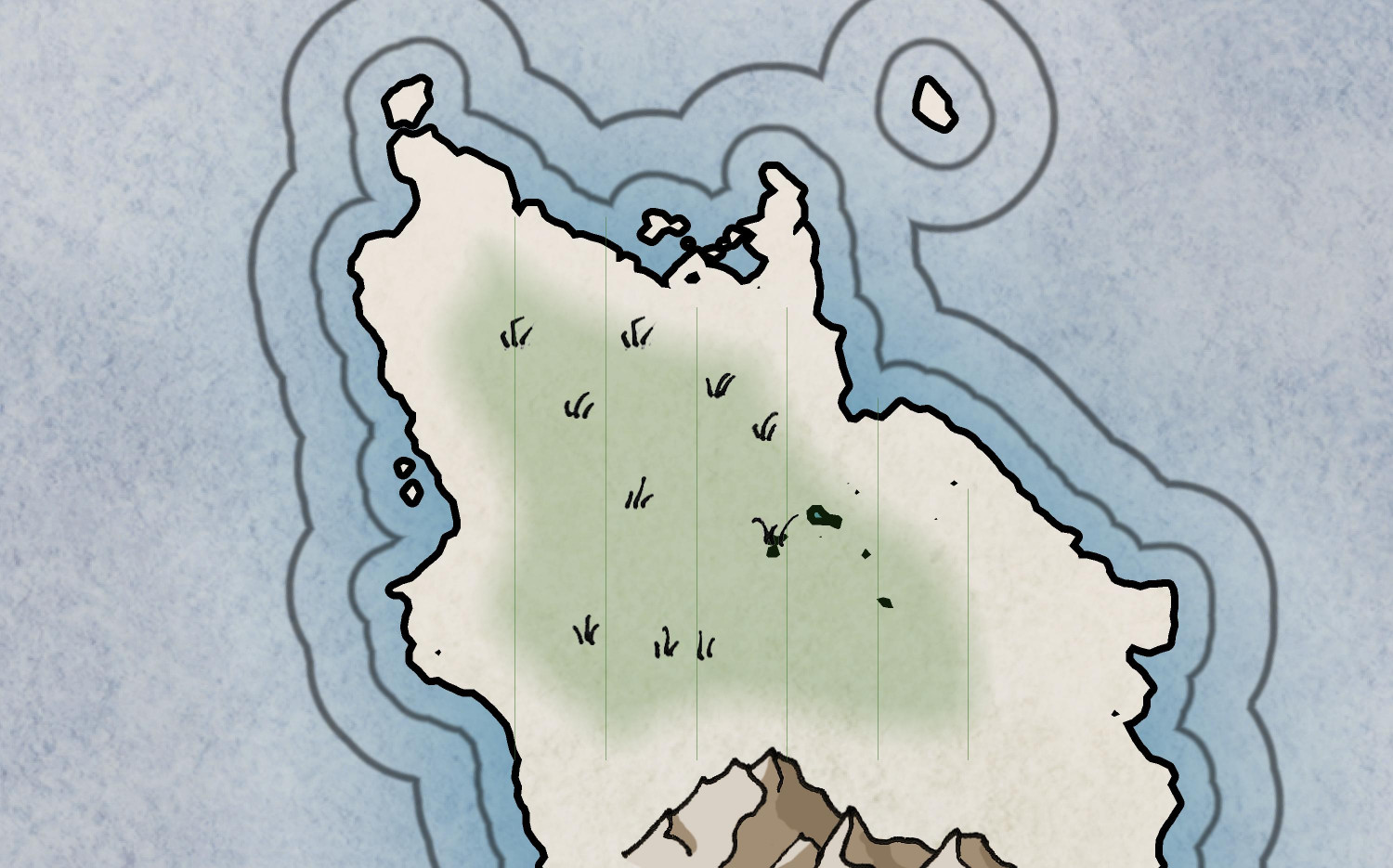

    Step 2 - Drew a mixed forest. What showed up was a green fill with lines instead of tree symbols.
    Step 3 - The green fill is on the FOREST sheet, not the TERRAIN FOREST sheet. Not sure if that matters but pointing it out just in case.

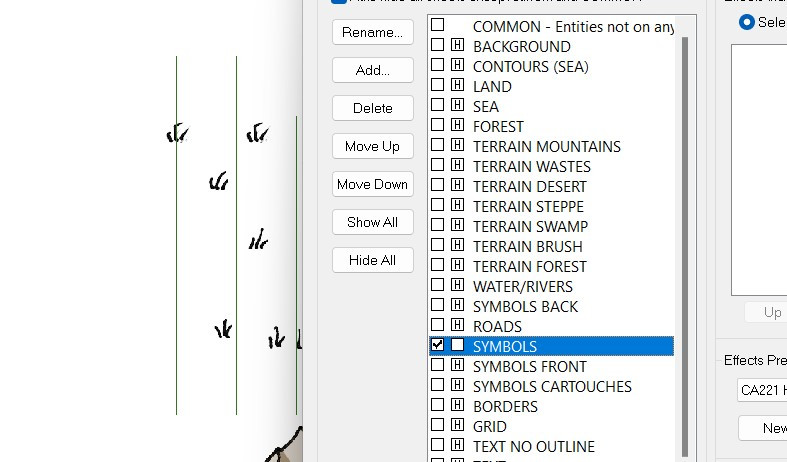

    Step 4 - The lines are on the SYMBOLS sheet, so it appears it's drawing lines instead of trees?
