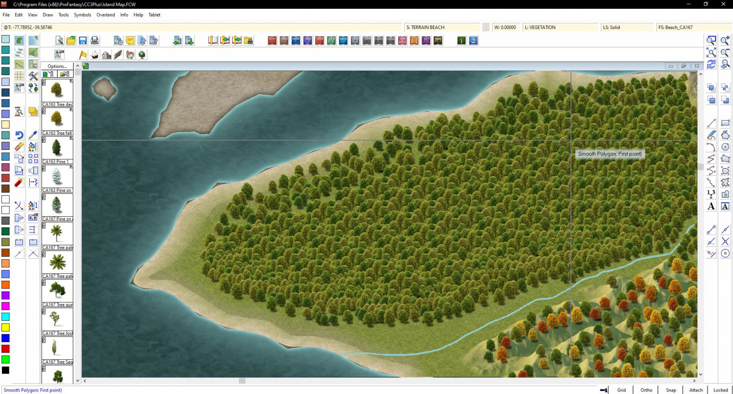

This is what it did, should it have that sharp edge from the beach to the grass? I'm fine if it is supposed to look that way, but if it's not then what could I do differently?

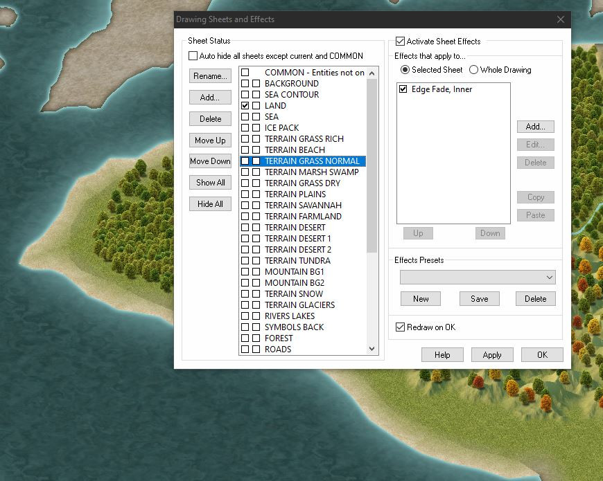

Put the grass and beach on different sheets, with Edge Fade Inner on one of them (the grass would be best, put it on the sheet above the beach (ie further down the sheet list)
Different sheets? Edge Fade Inner is already on the grass. I did exactly what you said and it didn't do anything different.
It's possible the beach isn't wide enough to go completely under the faded edge of the grass. Try editing the EFI on the grass sheet to make the faded edge narrower. The alternative is to use the node edit tool
to move the nodes of the inner side of the beach polygon further under the grass.
The nodes aren't visible in CC, so it's a case of clicking with the node edit tool on the inner edge of the beach poly until you grab one. You then move it by dragging the mouse and then click to reposition it. On to the next node... and so on.

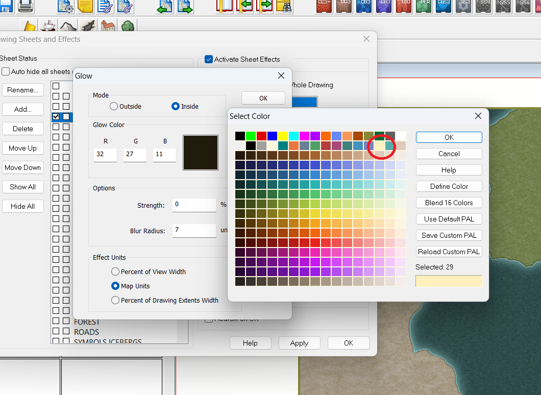

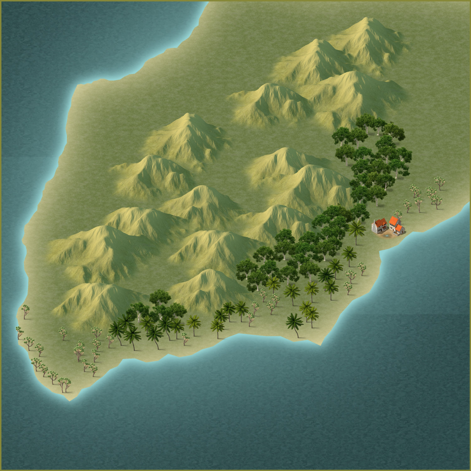

One option I often use on my overland maps is to change the internal glow of the SHEET land to a lighter color (I usually use #29).
This color can simulate a "beach coast" in a simple and quick way.

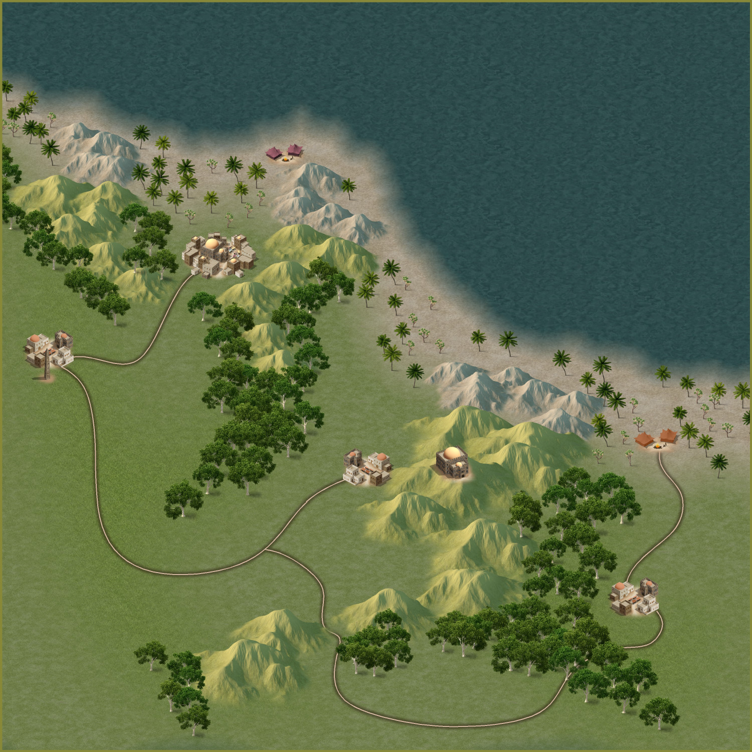

Another way to further emphasize the coastal aspect is by mixing in other types of vegetation closer to the coast, as in the example.
Just to elaborate on what Ricko said: on the LAND sheet, you'll see three GLOW effects. If you click on the first one and click Edit, you'll see that it's an inside glow with a dark color. (The other two Glow effects are outer glows that add the light blue to the coastal waters.) If you click on the color in the Glow parameters, you can change the color. Ricko is recommending the tan color I circled on the screengrab.
One other thing just occurred to me. See where it has a Blur Radius of 7? If you want bigger beaches, increase that number.
Of course, as @Royal Scribe said, by controlling the radius you have a greater or lesser "coastal strip".

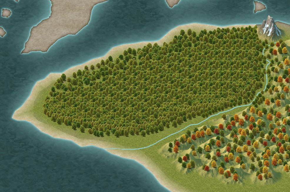

I've been thinking about your map and the beach. If you want an even closer or more local map you can directly use the marine dungeon as the base of your map, working with the Edge Fade Inner effect on the land and/or also on the ocean.
Like this example.
Cheers

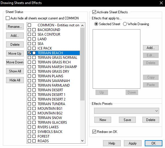

And... another possibility is to use two Lands sheets - both with inner edge fade and the lighter one - beach if placed below another more yellowish, greenish, rocky, etc. When you open this file you will see in the sheets a new sheet called Land Beach -------.
