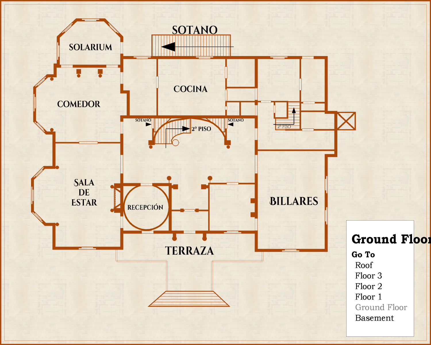

One of my floors so far with the buttons on the right.

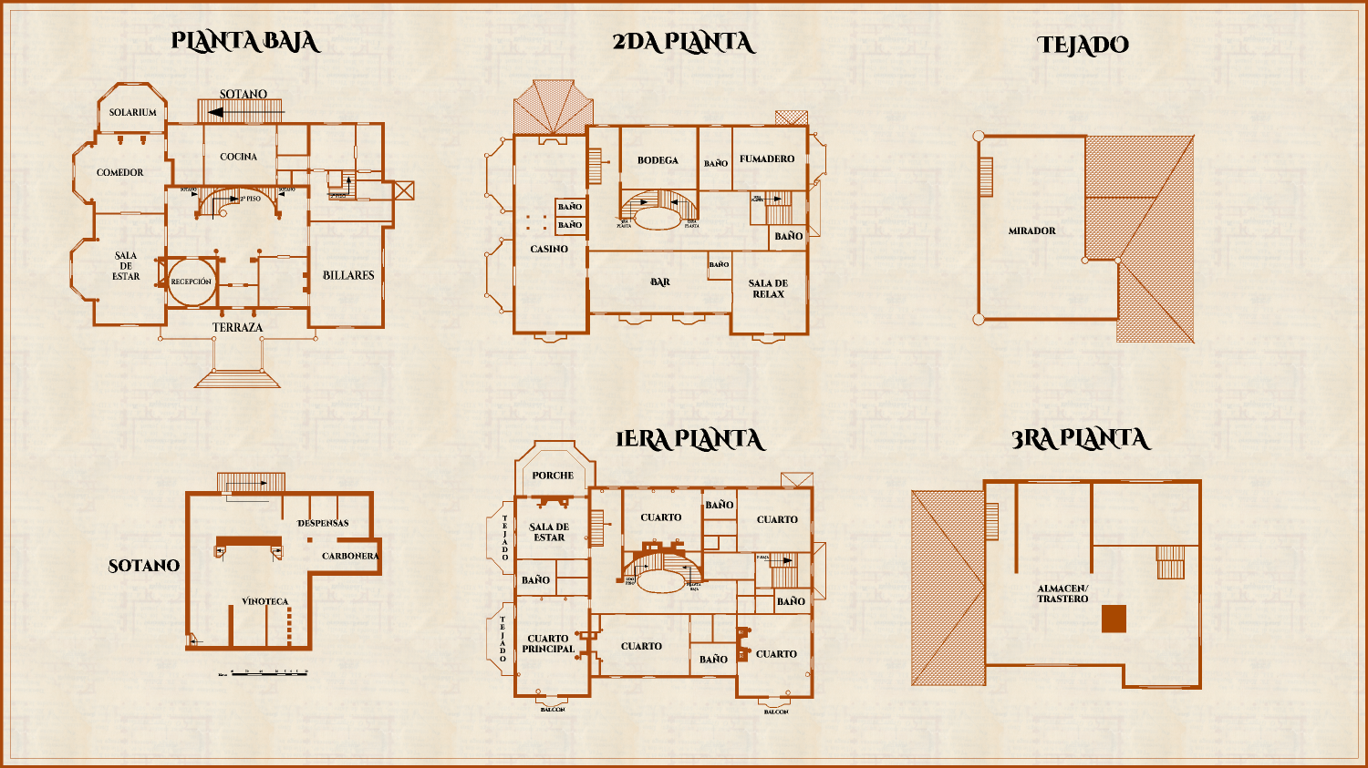

    And just in case you were curious (and also because it's my first map) here is the final result :D
    I believe that for 3 week with the program the result it's not hideous. Now I have to learn how to draw spiral and elipses, but all in due time.
