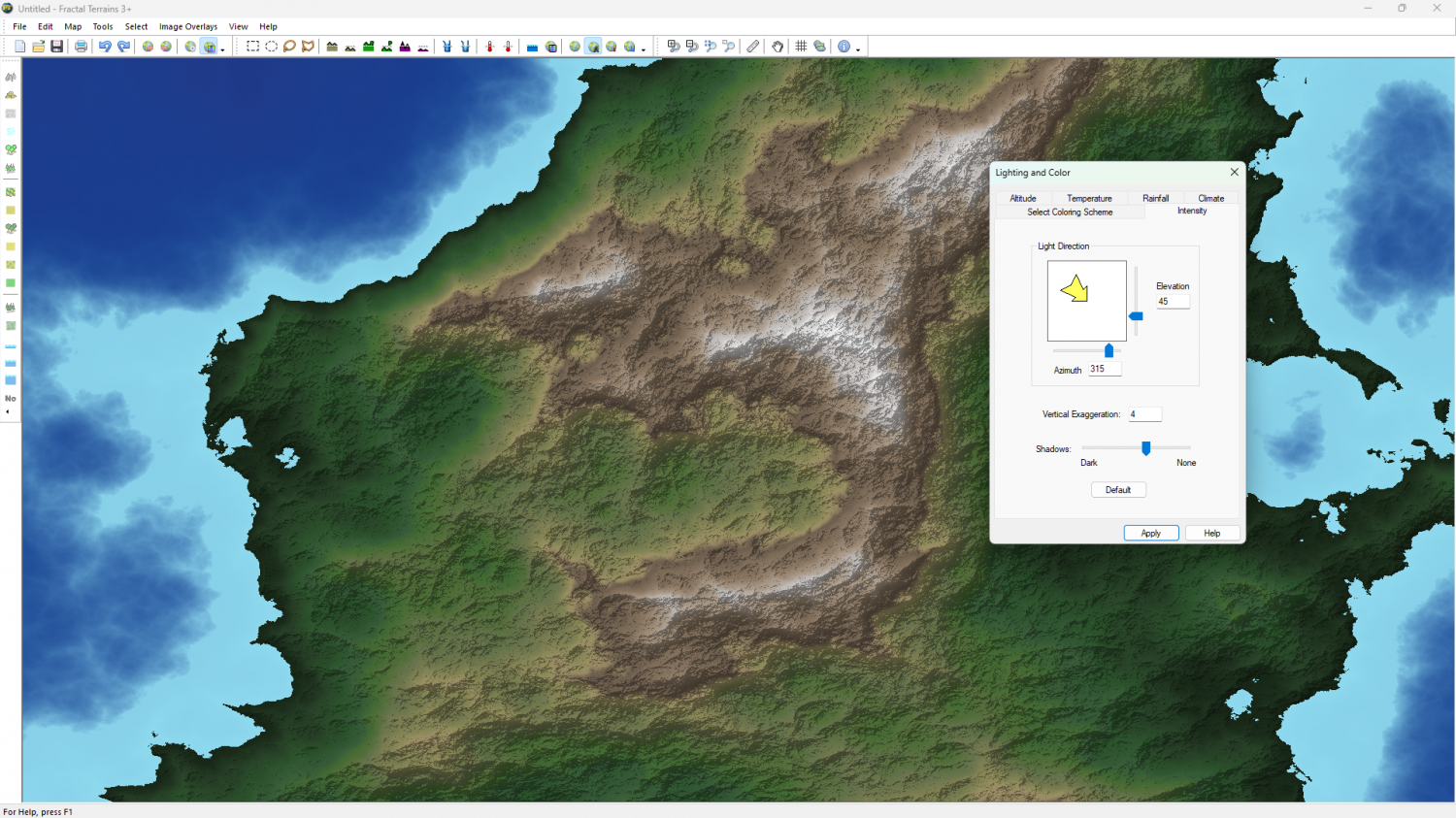

    FT3 shows elevation already. Most of the shaders blend the contours and add hill shading.

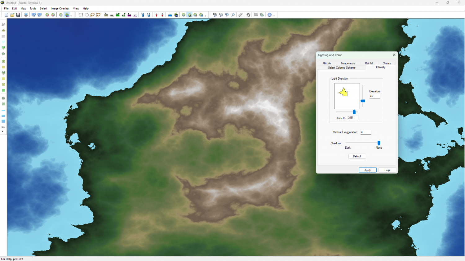

    If you open World Colouring and find the Intensity tab you can switch off the hill shading by moving the Shadows slider to "none" and hitting Apply.

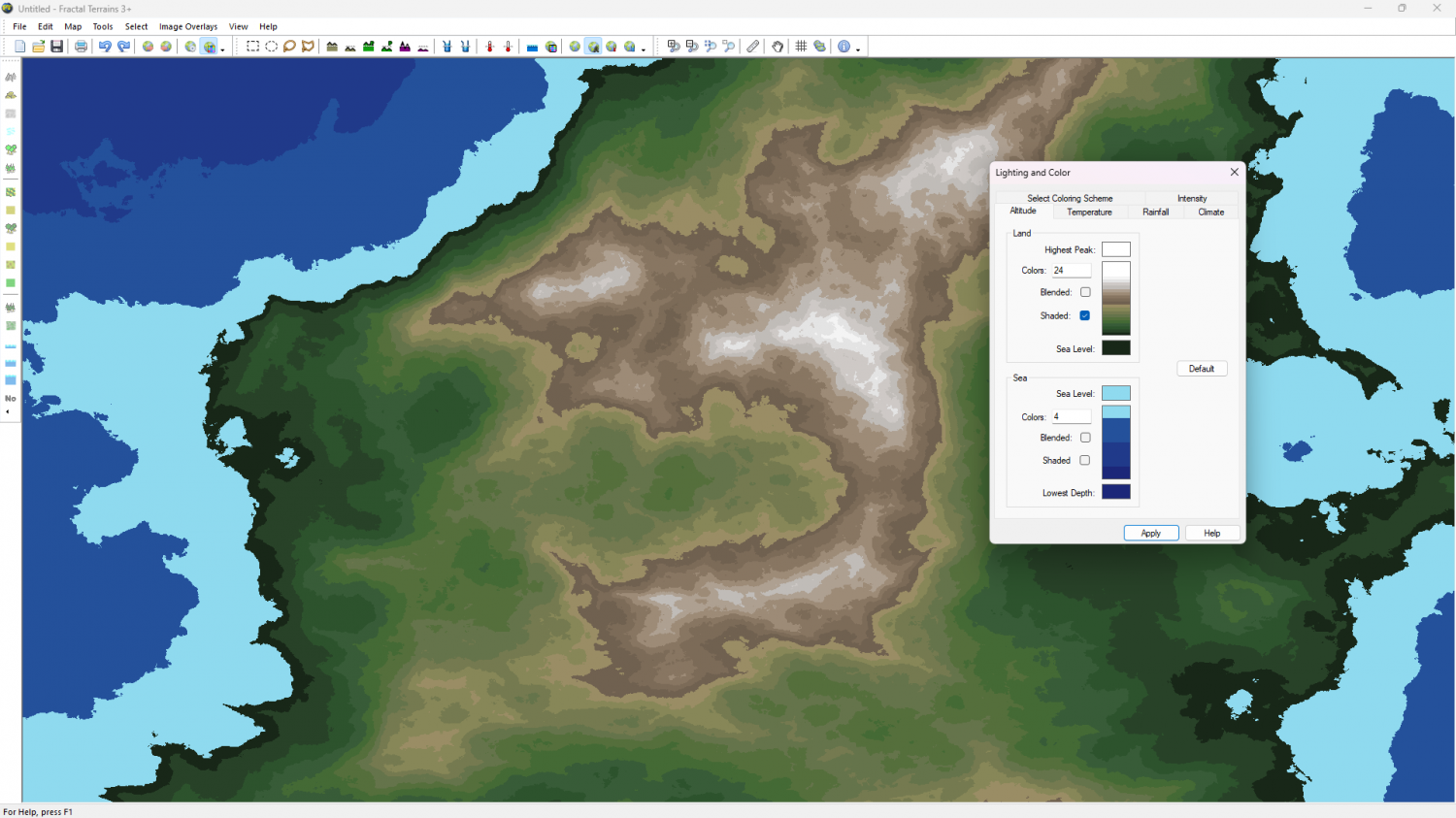

    Then if you go to the Altitude tab and uncheck the Blend tickboxes you will see something more akin to contours.
    How many contours you see will depend on how many colours there are in the colour scheme.
