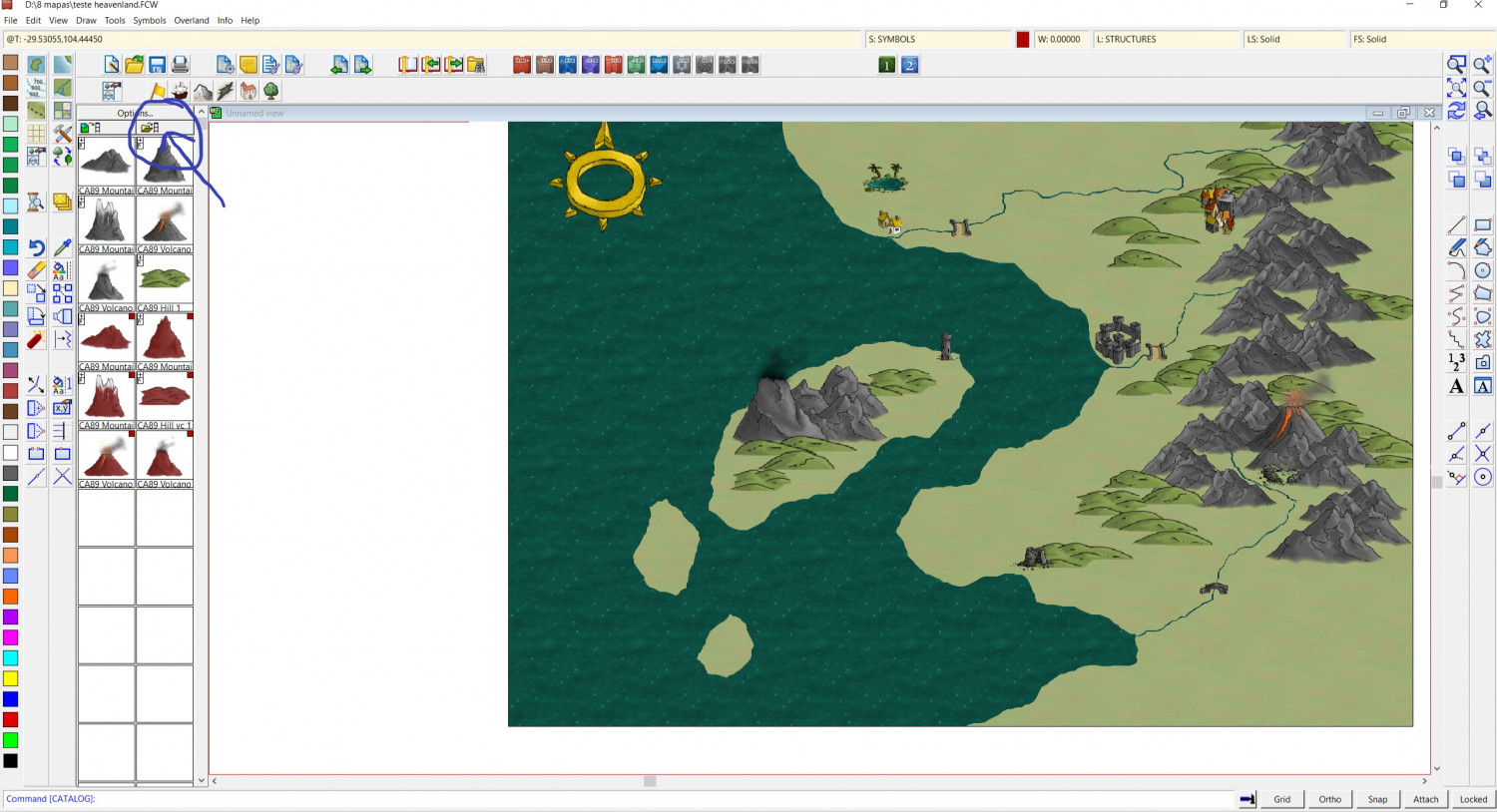

Not sure where to find the symbols that aren't a part of the map type that I'm using.
Hit this button and will open your CC3 folder

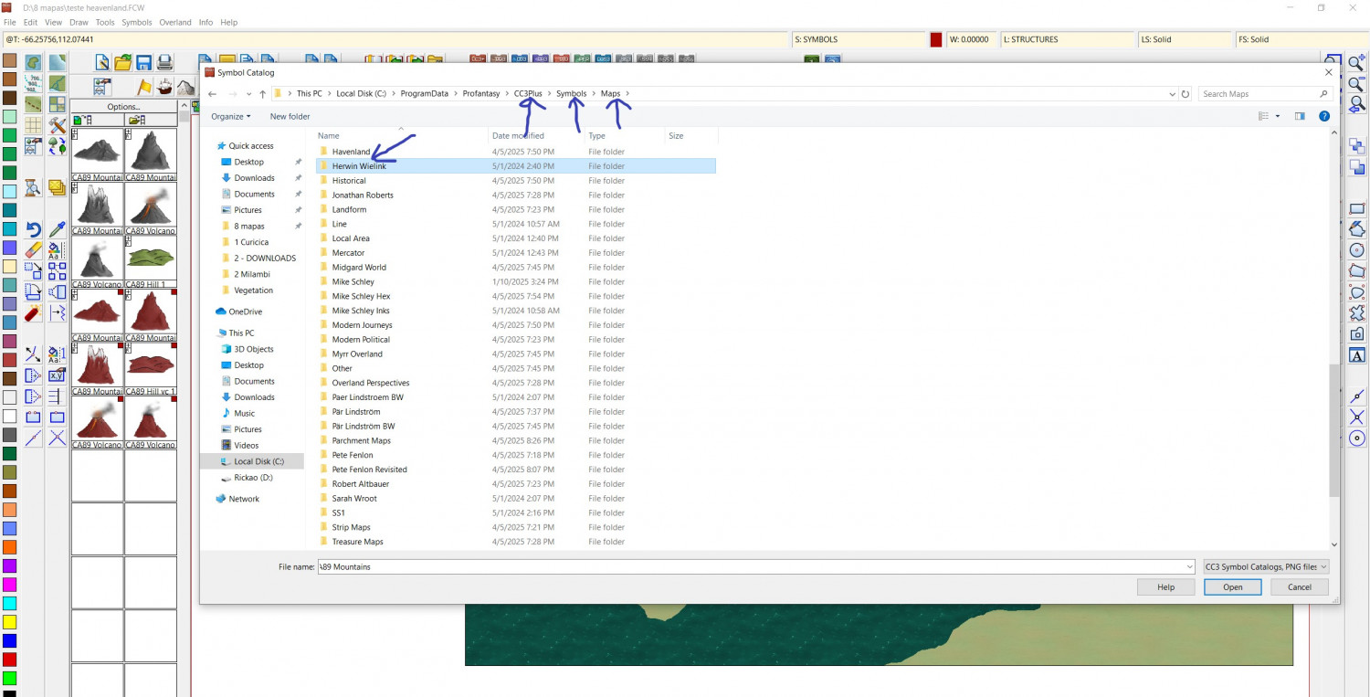

make sure you are in Cc3 > Symbols > maps
Go to the Herwin Wielink image archive, go to the COAST subfolder and there is your pier.
So that's how you do it! Thank you!
