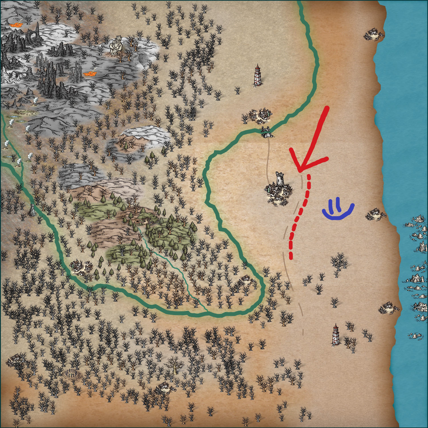

How can I change the points of the dotted Roads so that they are uniform (and less spaced)? I also don't want this Morse code from the example, short - space - short - space - long.
So, to the best of my ability, I went to custom drawing tools > custom tool properties > linestyle and, like a troglodyte, I tried them one by one without success in finding what I "want".
Thank you very much.
Dotted lines don't always behave the way you want. Most often, if you have longer bits in the line you can try fractionally adjusting the nodes using the move node tool. It's a fiddle, but a handy tip is to use as few nodes as you can for the line you want.
Ok, I understand. Any other way to bring the dotted lines closer together and make them more united? I see that some styles have the dotted line closer together.
For example, leaving the road with small dots like the Wyvern road.
