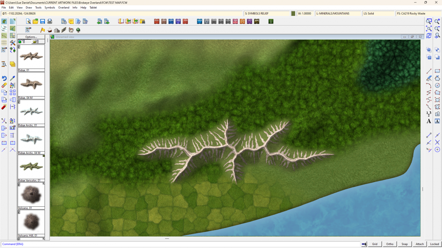

Unfortunately, Quenten, I have already added the mountain and hill symbols sheets together as one "SYMBOLS RELIEF". It shouldn't be too confusing because there are only 2 actual hills in all of this, and both of those are volcanic hills. These are the symbols in the map so far.
So you see that most of the bumpy bits are actually polygons maskquerading as hills.
There will of course be many more ridge components and other features, like outcrops and fissures, but they will mostly all go on a very short list of "SYMBOLS..." sheets.

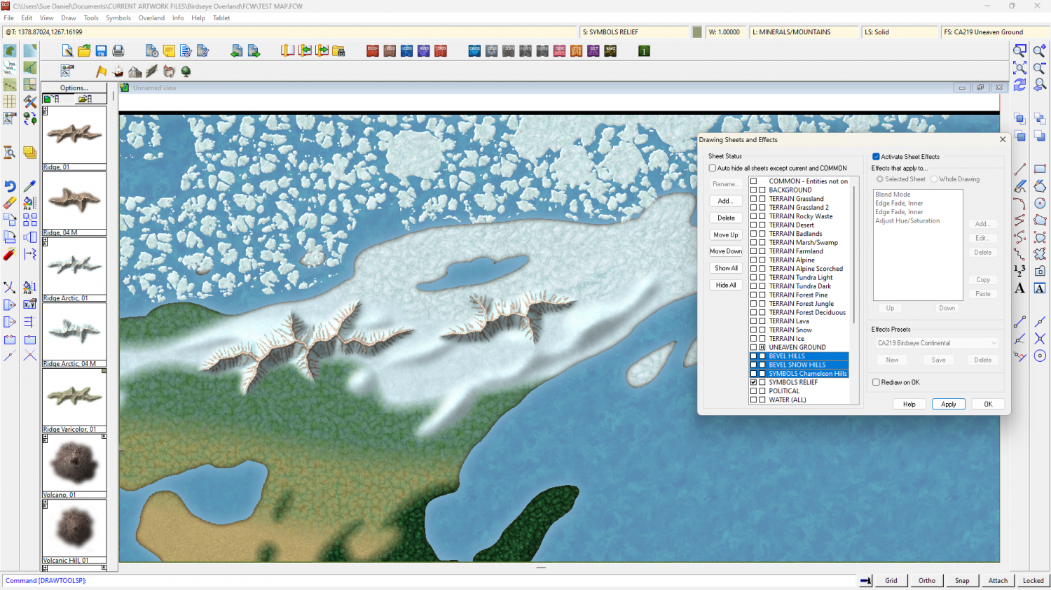

As you can see, if you take all the TERRAIN sheets out of the mix, the rest of the sheet list is surprisingly short, and the whole list would easily fit in a single dialog window - if not for the TERRAIN sheets. I'm a bit concerned by the psychological effect of such a lengthy list when they are all put together. If you can think back to when you began mapping with CC, would this have seemed quite a daunting wall of sheets?
I think it's helpful to have all of those named terrain sheets (TERRAIN PLAINS, TERRAIN DESERT, etc.). Allows for different sheet effects, and to allow things to render in the correct order.
Sometimes on smaller dungeon-scale maps, I just do TERRAIN 1, TERRAIN 2, etc., which gives me flexibility (I might have a couple of layers of dirt in one area, dirt and grass in another, etc.). Of course, that doesn't work if you need different sheet effects for different types of terrains. For large overland maps, I think it's helpful to have them named separately. Spectrum does it that way and it was very helpful when I was doing an area for the Atlas.
Naming them all independently also allows me to create drawing tools that put terrain fills on the right sheet first time. No messing around trying to move things between numbered terrain sheets.
I wouldn't worry about the length of the list of sheets here, Sue. You can't really design systems on the basis they might trip-up people fresh to the program, as it's more important they do the job well. If there's a concern their number could be intimidating, that's something which could be addressed usefully with a note or two in the PDF mapping guide for this issue.

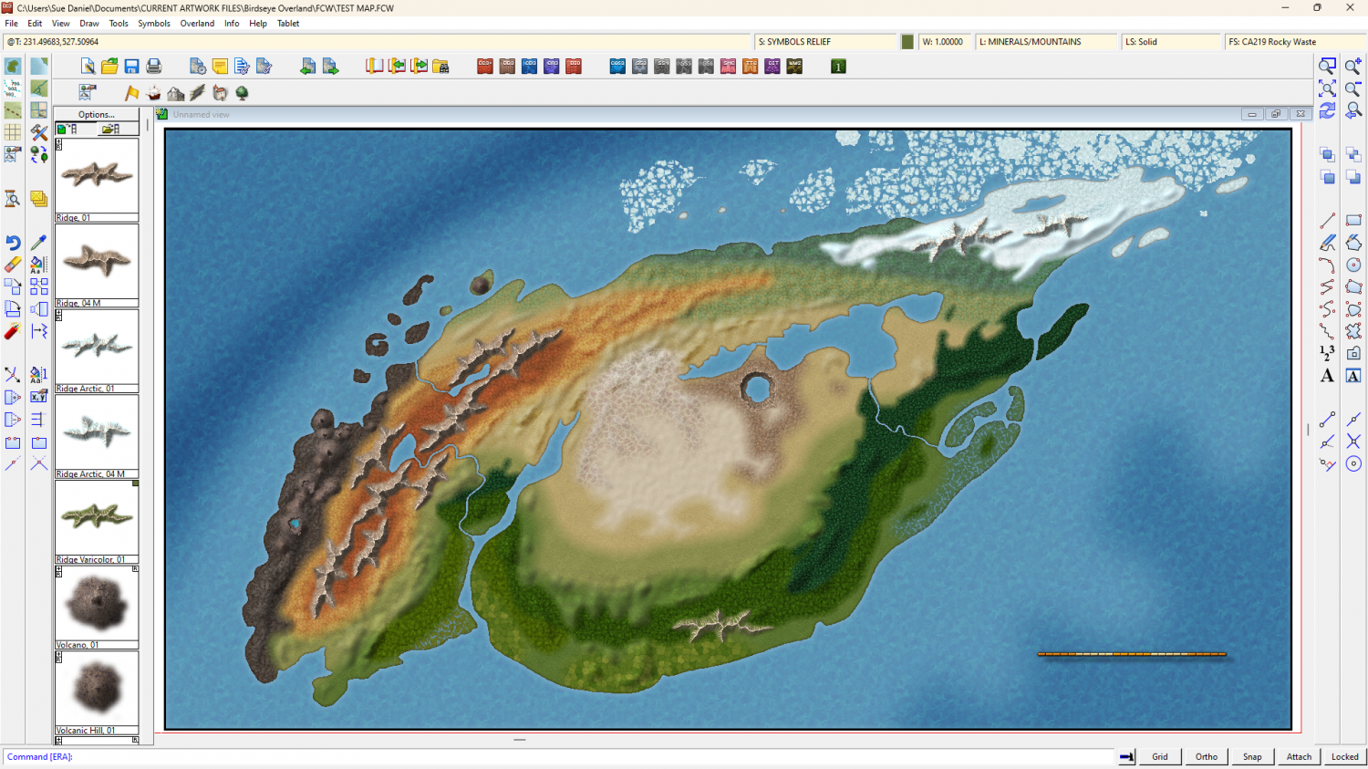

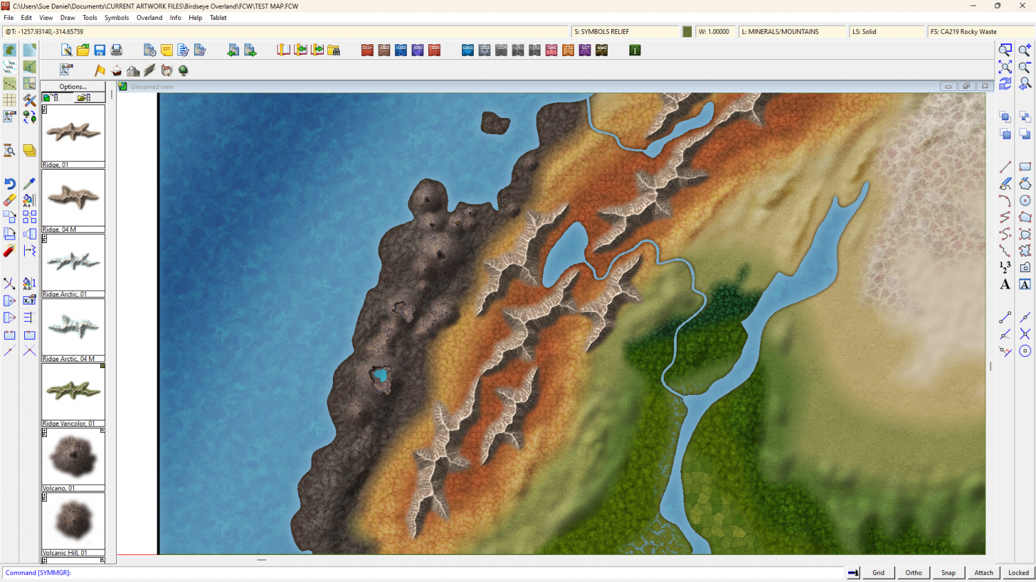

I've done quite a bit more work on the ridges, and also the overall colour scheme.
And there are varicolour versions as well, with special colours in the custom palette to match the style fills.
Smaller ridges and mountains to come, along with other things as I think of them.

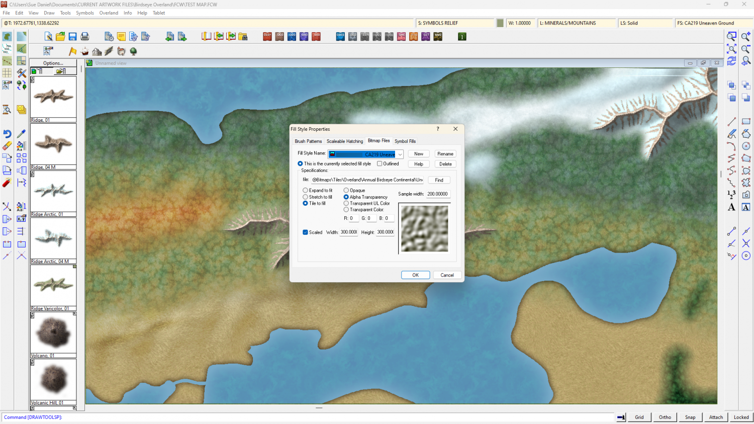

The only thing that's a bit worrisome for me is the 'fuzziness' of the smaller hills and/or dunes. Is this just from the sheet effects? We can alter that ourselves?
thanks
Cal
I like the fuzziness. Looks like a topographical realistic view.
Thank you :)
@Calibre - most of that is a texture called Uneaven Ground, which you can use... or not, according to taste.

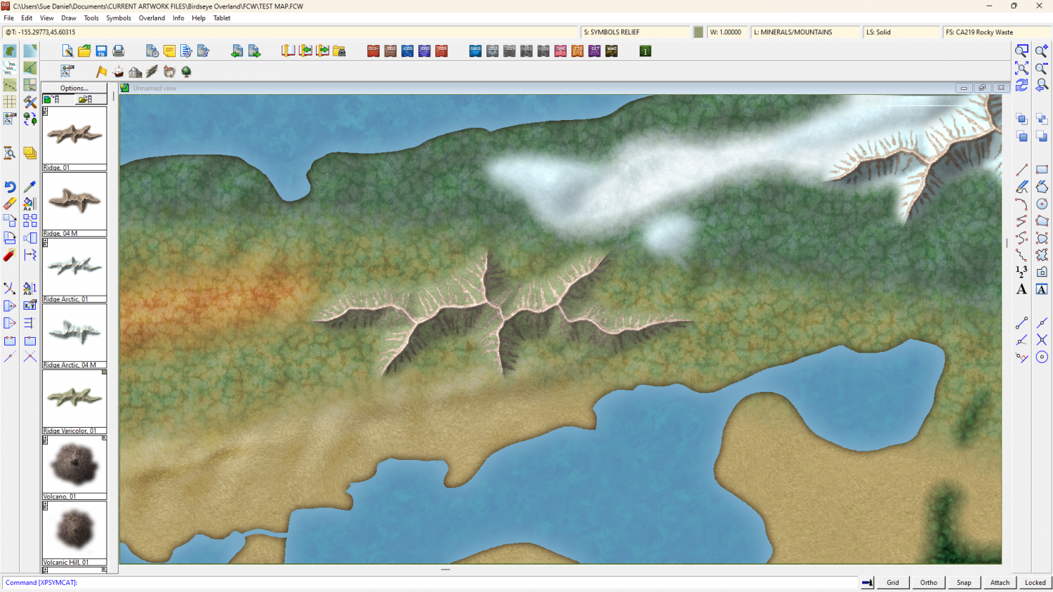

This is the map without it.

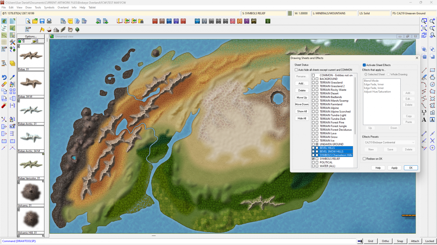

The 3 highlighted sheets have different kinds of hill on them with different sheet effects - bevel hills on 2, and the chameleon hills on 1.
You can adjust the sheet effects as you prefer. I like a more natural rolling hill effect but you can make the edges harsher if you prefer.

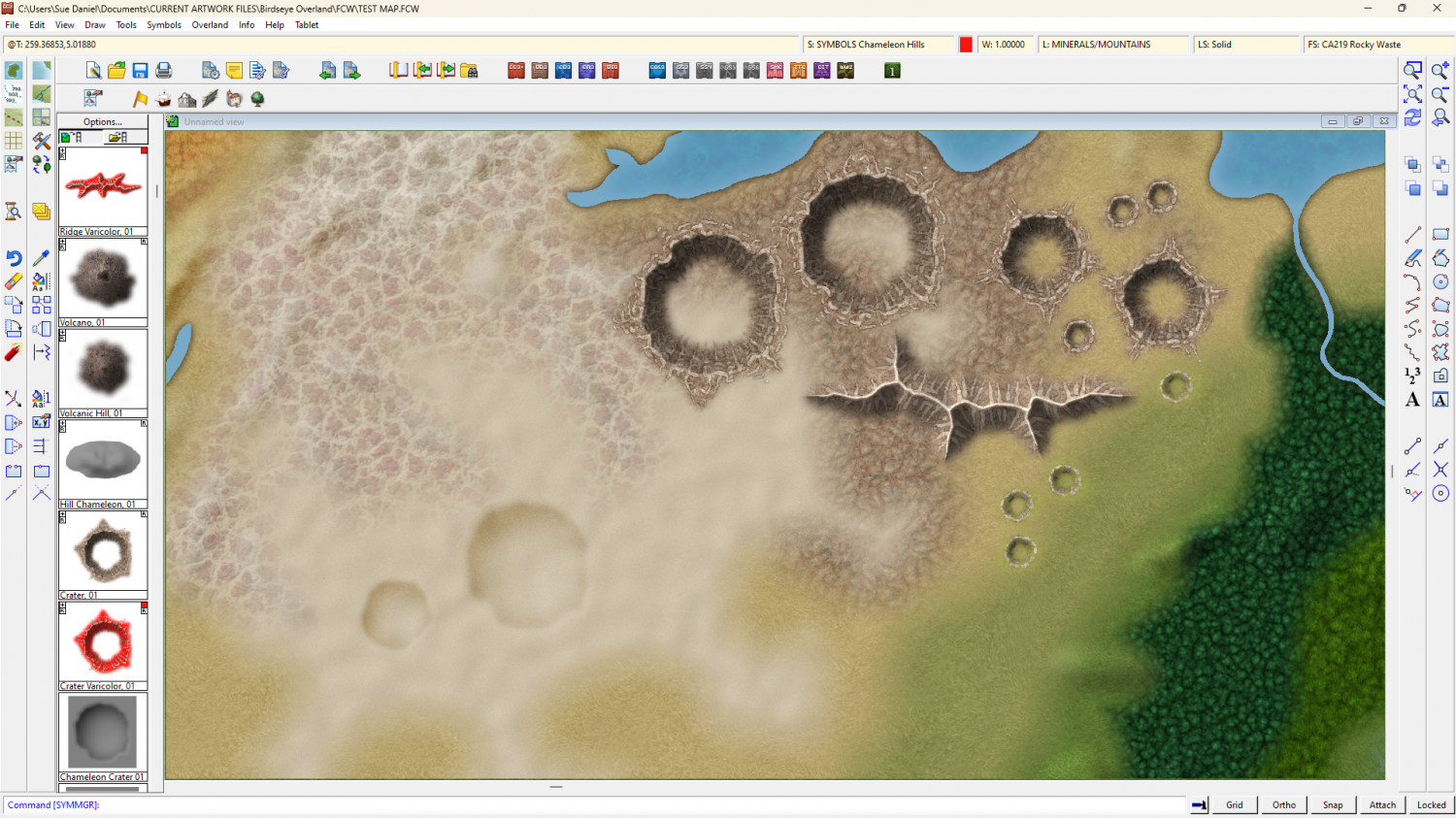

Do you think this is enough craters?
