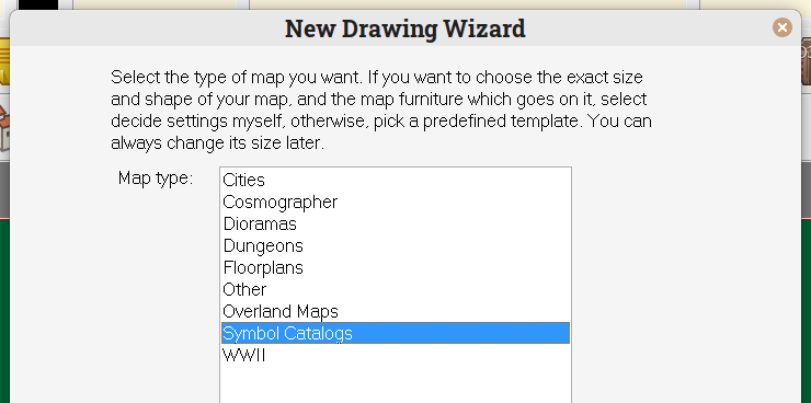

  • I have CC3+ running on Fedora + Cinnamon. But I can't use the New Drawing Wizard, because some text is too thin and faint for me to read.
    I installed the Microsoft standard fonts, but I wonder if I'm missing other fonts CC3+ expects, or if there's any way to bolden them enough for me to read.

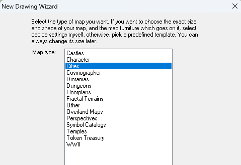

    I know practically nothing about Linux, but for comparison this is what the same dialog looks like on a Windows PC. The font is different, but that's probably some kind of MS font that might not be available on non-MS machines. At a wild guess it's a system font your own non-Windows system has substituted with one of it's own?
    The font used by the CC3+ dialogs is "MS Sans Serif(8)", which your system's font substitution is replacing with something that's installed locally. I recommend adjusting the Windows dpi settings to get the appearance of a larger font.

    I don't use Linux with WINE so I probably can't be of much help here, unfortunately. A quick search turned up WINE fonts are ugly - Support / Third-party Applications - Manjaro Linux Forum, which has some suggestions and no conclusion, but I expect that you've already seen that link. It does look like the aliased font issue described above (the WINE renderer isn't giving antialiased fonts for dialogs) might be at the root of the problems that you're having because the fonts are all only a single pixel wide.

    I decided to try CC3 on Windows, and I encounter the same too-thin/too-faint text there, too. It's like my Linux screenshot from April 27th, not like Loopysue's Windows screenshot.
