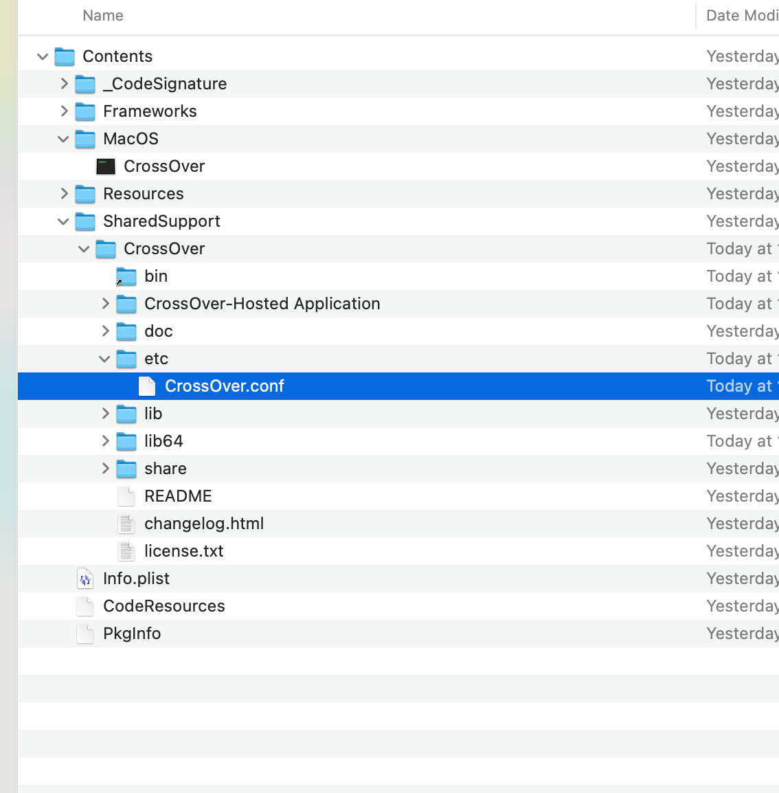

    If you want to run bottles from an external drive then you need to edit the crossover.conf file
    here is my edit , note you will have to re edit each time you upgrade crossover as the file exists inside the crossover app
    my external drive is called 2TB SSD so change that part in the line to match your setup
    [BottleDefaults]
    [EnvironmentVariables]
    "CX_BOTTLE_PATH"="/Volumes/2TB SSD/bottles"
    right click on crossover.app and view contents and use the text edit to change and then save
