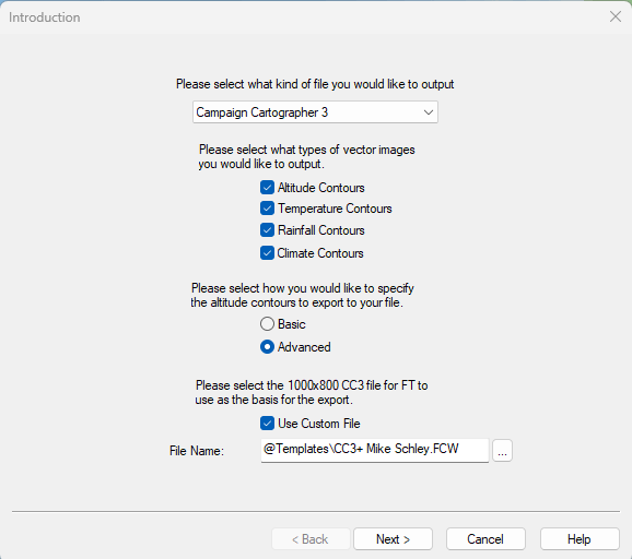

    If that's the result of picking the Mike Schely option during export, then it looks like there is either something wrong with your export options, or the template file is missing.
    Can you in the export dialog after picking the Schley export setting hit the Edit button instead of the Export World button. On the first page of the editor, make sure the template is set like this
    Also, to confirm the file actually exists as well, hit the button with the three dots there, that should bring up a file open dialog that should show the available template files. Make sure the Mike Schley template is actually among the files shown here.

    Hi Monsen,
    It worked when I changed advanced to basic in the menu. Many thanks ;0)

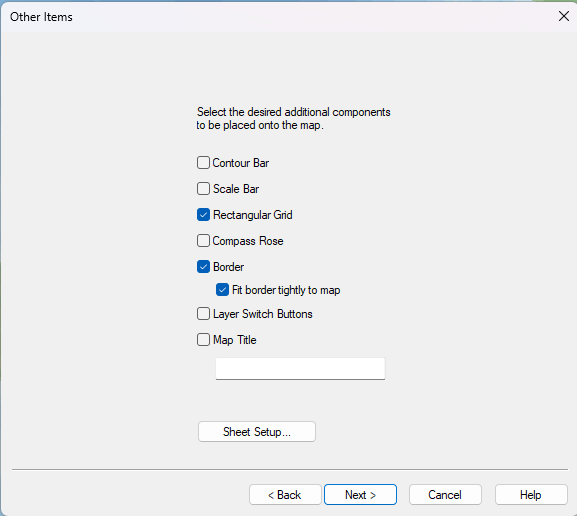

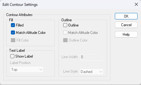

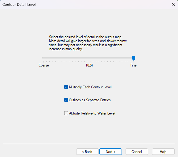

  • I apologize for necroing this post. I just started using CC3+ and Fractal Terrains 3+, and in my ignorance, I altered the Mike Schley default export settings while experimenting.
    Can someone post the Mike Schley settings for Fractal Terrains 3+ export to CC3+? I altered the climate selections and other checkboxes...
    Following the steps in this thread got me closer to the original settings, but my oceans are a solid color and my landmasses don't look anything like the above screenshots.
    I'm guessing the main issue is in these second and third screenshots..
    Thanks for any assistance.
    Part of your problem at least is all those contours.
    The Mike Schley style isn't a style that relies on height contours, it uses symbols. So there wouldn't be appropriate fills for those contours which probably leads to all those solid filled areas.
