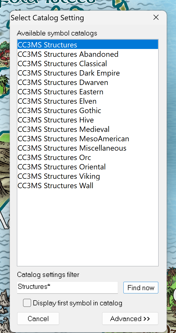

  • This is how I set up the Structures for Mike Schley - each of the submenus has its own catalogue, which I made using the method to create your own symbol catalogue by importing the png symbols from the relevant png files into the new catalogue. And I find it so very simple now to use and find all the symbols I need.
    I have done similar things with vegetation and Borders.
