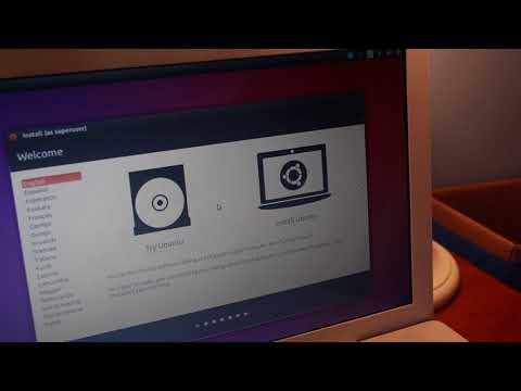

09... Is this your primary computer or one you just held onto after upgrading? How much ram and did you replace the original hd with an ssd? All of these things speed up old macs. I don't know how many Mac apps you use, but maybe you want to move to Linux. I believe it runs great on late 2000 macs and you could get crossover.
