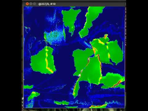

I have recent been thinking about using tectonics to generate the map, for example see or Lauri Viitanen thesis (located here: https://www.theseus.fi/bitstream/handle/10024/40422/Viitanen_Lauri_2012_03_30.pdf?sequence=1&isAllowed=y). Of course both of these methods would need to be improve considerably, especially for spherical worlds. Then we would need some way to import the data in CC. As I'm finishing up a Masters in Applied and Computational Mathematics I've not had time to fully investigate these ideas.
