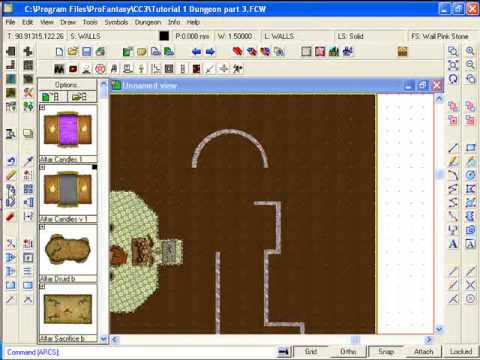

    If you are using DD3, there are several helpful tutorial videos done by Joe Sweeny covering all the basics of room construction, including one showing how to draw round rooms and arc-shaped alcoves here on YouTube:

    If you need perfectly round rooms, all you need to do is to click the room button in DD3 (top left button) and it should offer you the option.
  • Once you get a basic round room done. Save as room02, room03, etc. one for each level of the tower. That way they will always match.
