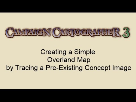

    I made a video on this. Check is out here:
  • *smacks forehead* doh! Okay, now that makes sense! In the manual it goes from importing the image on a separate sheet, to the bumping forward (not saying 'move the sheet down'). It doesn't mention the tracing that comes in between. That's why I got confused.
  • daplunk, I love your video! Not only did you show me a good alternate way of doing the import/trace, but you also gave me ideas and inspiration to use some of those land fill tools I've never used. I love the way you showed some techniques in a way I hadn't thought of... such as using the hills, then putting mountains right on top! Or using the forest drawing tool, then putting other forest symbols on top to get rid of the squares. And your map turned out fantastic!
